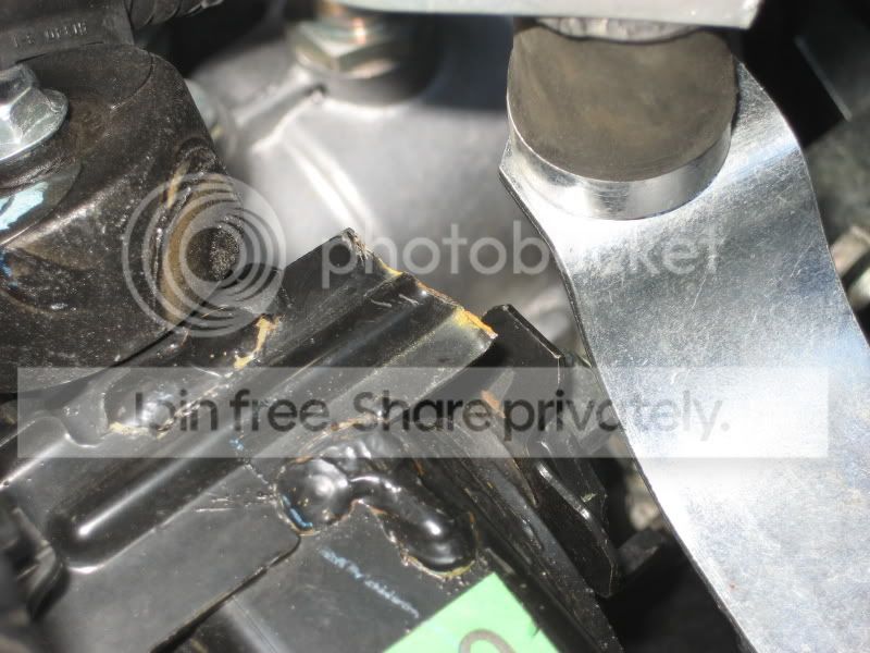

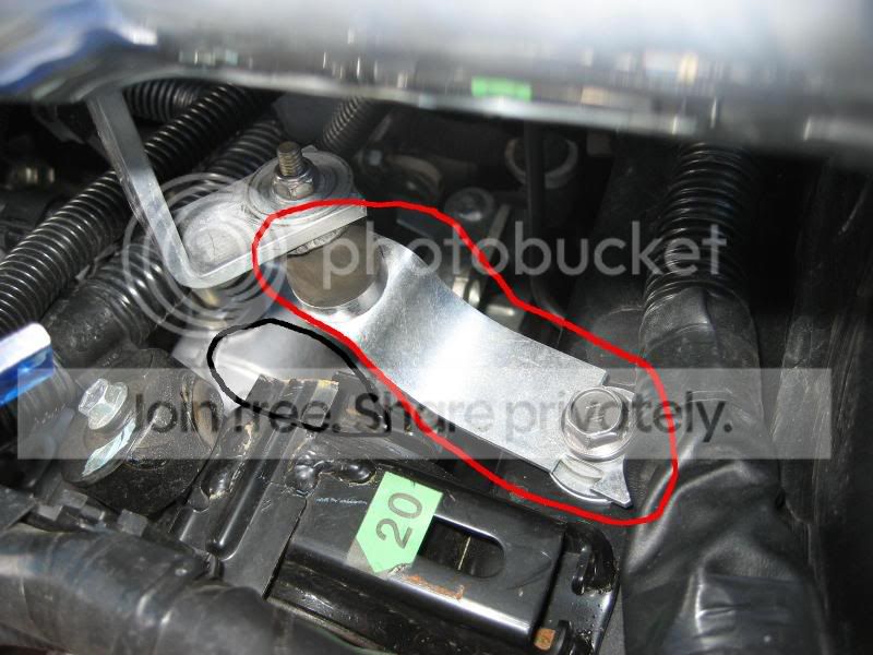

well lately i have been hearing some new sounds from my CAI after taking my Ingalls ETD off and selling it. today i got annoyed and investigated the problem and found that the bracket broke, just like others have had happen on theirs. well i fixed it pretty easily. i looked around the garage and pretty quickly found a nice piece of metal and made it work.
here are some nice close up pics so everybody can see what i'm talking about....
circled in black is where it broke, and circled in red is my new bracket that i fabbed up.

i had the ingalls ETD the whole time i had the intake.... then i decide to take the ETD off and sell it then the thing breaks. i should have seen it coming. haha. no big deal though, it took me like 15 minutes to fix it. and this is waaaayyyy stronger than it was. i was thinking i would just get it welded but i was worried it would happen again.

nah, i'm sayin the ETD prevented this from happening until now. i took it off and sold it. now a couple weeks later i hear new noises and find this. the etd doesn't let the engine move very far at all so it would easily prevent this from happening.

yea thanks, this bracket is pretty thick. i'd say a good 3/16" or 1/4". i don't know what it was for but i found it in the garage here at the house just laying around. i hope it wasn't for anything important.
