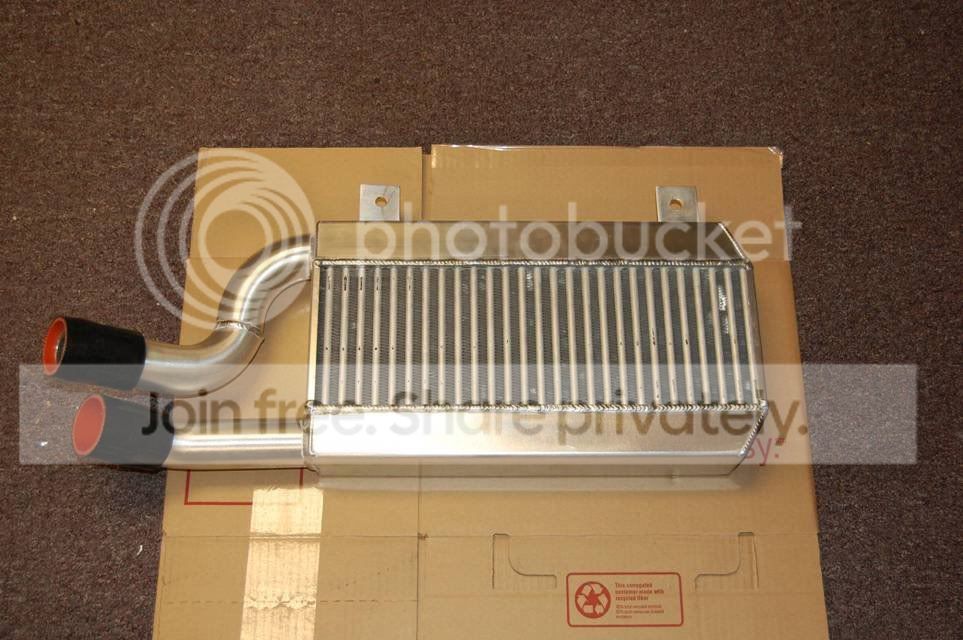

INTERCOOLER

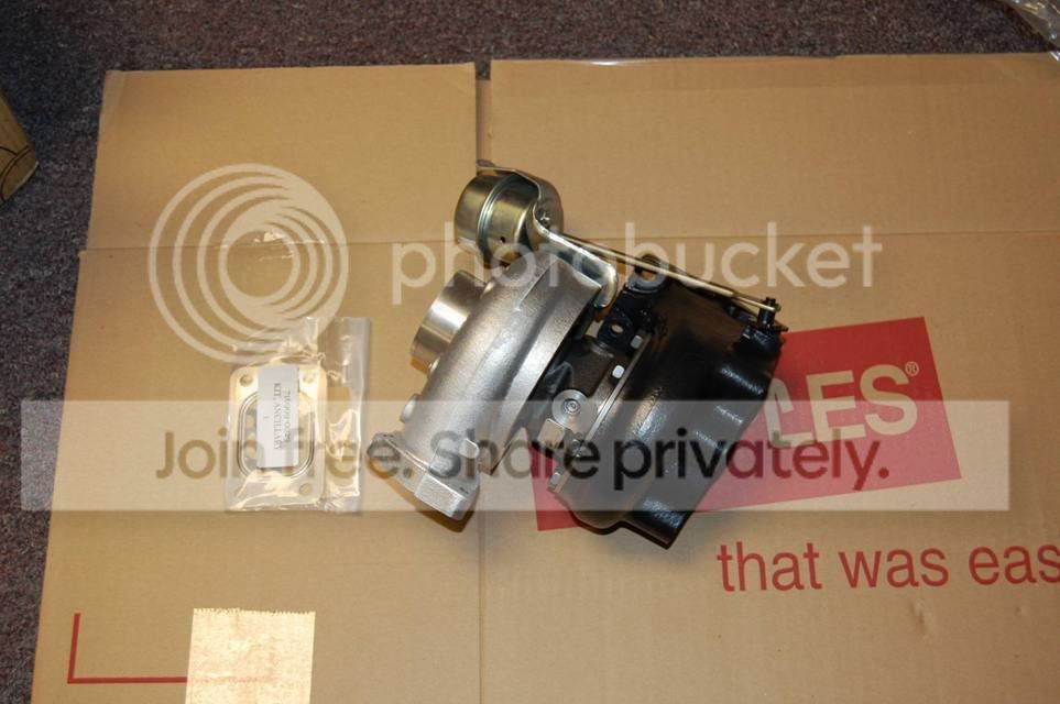

TURBO

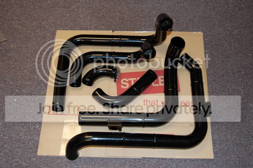

PIPING

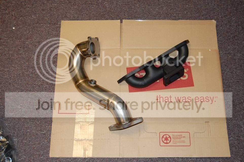

DOWNPIPE & MANIFOLD

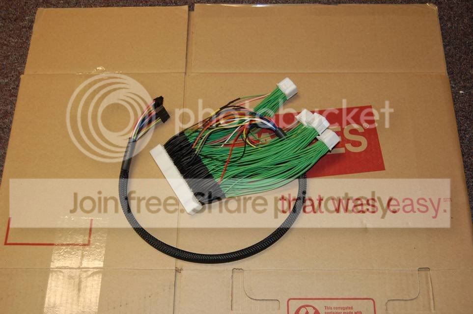

BOOMSLANG HARNESS FOR AEM FIC

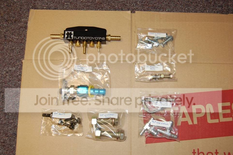

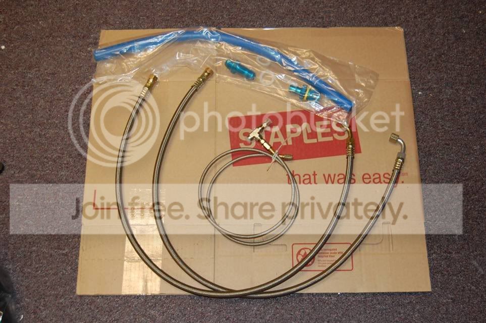

OIL & WATER LINES
VACCUM BLOCK & MOUNTING HARDWARE FOR KIT

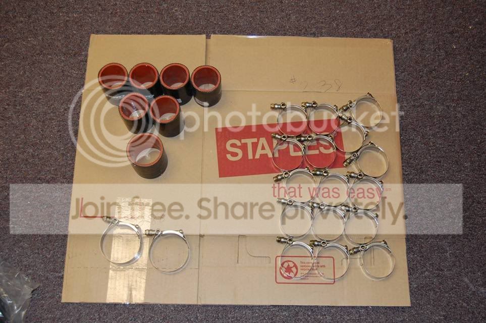

COUPLERS FOR PIPING

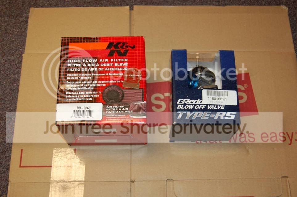

INTAKE FILTER & BLOW OFF VALVE
ANYWAYS THIS KIT IS VERY COMPLETE WITH EVERYTHING YOU NEED. ALL YOU NEED TO GET IS GAUGES, CELICA OR TC INJECTORS FUEL MANAGEMENT, SPARK PLUGS AND THATS ABOUT IT TO GET YOU GOING

DUDE!!!! Todd didn't send me a complete kit, no wonder why i had so much FU(K!NG trouble!!! You have alot of parts that didn't arrive with my kit.
1.) The blue oil fitting under the vacuum log
2.) H20 lines fittings
3.) My downpipe didn't have the bung welded in it
Lets see what you have that i didn't get.
