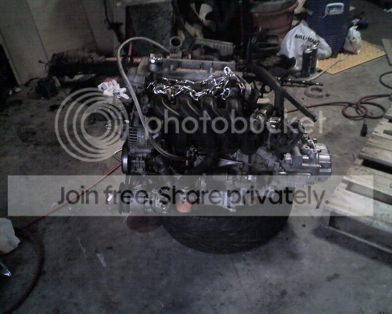

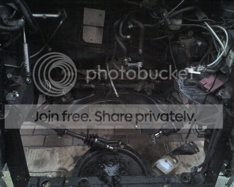

ok so i have had to pull the motor and replace it so i took a few pics of th carnage to show you guys.....while im at it im adding the fuel rail bigger injectors fuel pump and a couple other goodies...keep watchin and ill add as it goes on.
Old Feb 9, 2008 | 07:39 PM
biohazardous_customz's Avatar
Posts: 384
Motor out
the hole...lol
full frontal

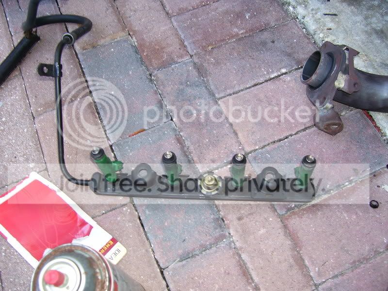

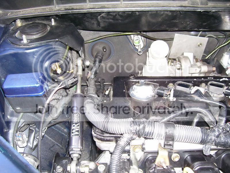

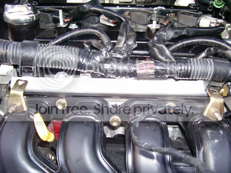

ok got everything installed last night with the exception of the fuel pump and fuel rail....for some reason if with the new seats and seals and making sure everythign was seated properly it refused to stop leaking from injector 1 so i went ahead and stuck with the stock rail for now and im gonna just get a diff rail then install the fuel pump.....
also goin to and gettin her tuned and dynoed. so i will post results later today.
but for now more pics of the build

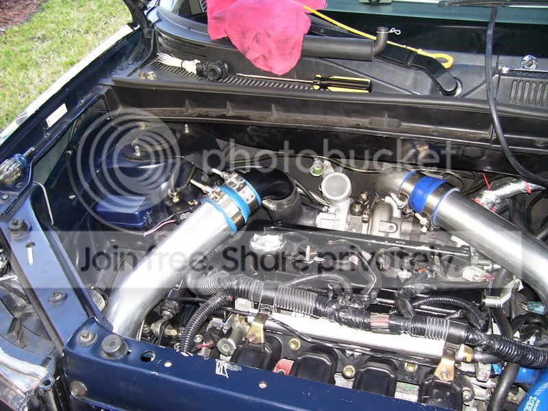

turbo in
new rail in (before i had to take it off)
stock rail

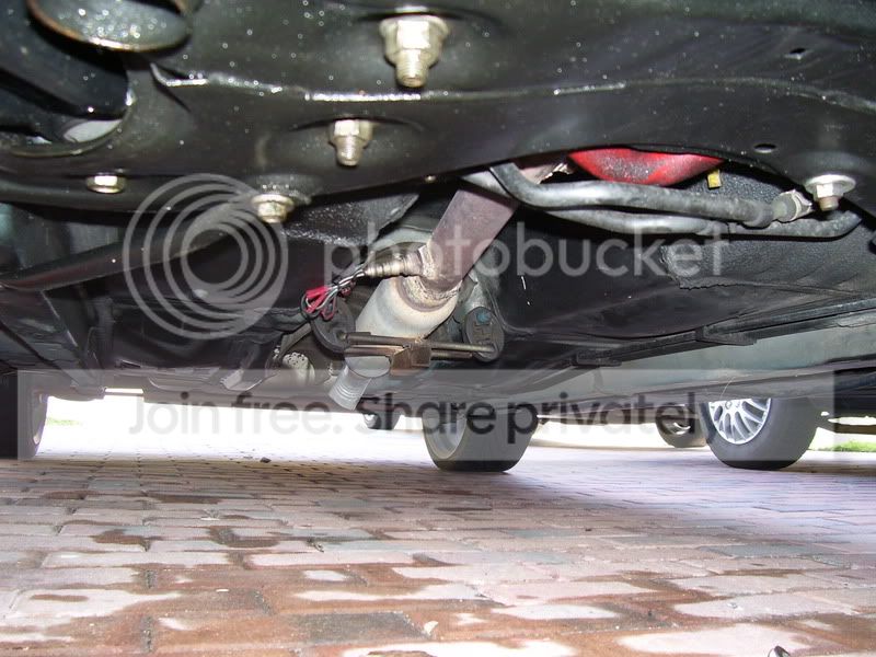

little shot of my dumped exhaust

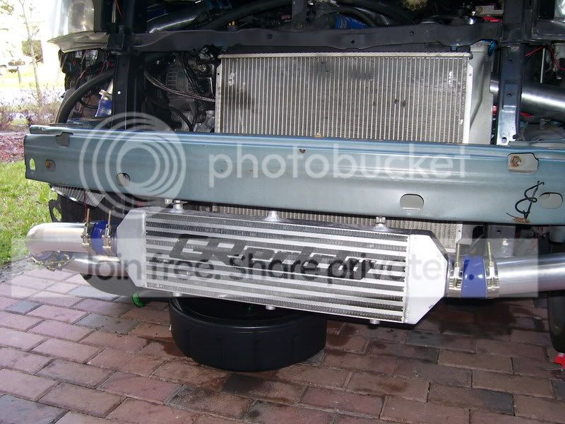

starting the rerouting of the larger piping
getting the intercooler lined up

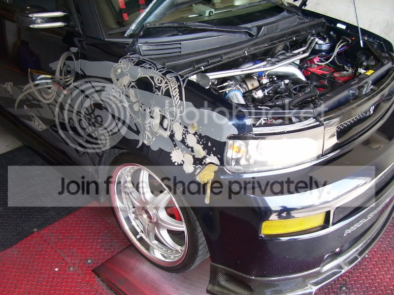

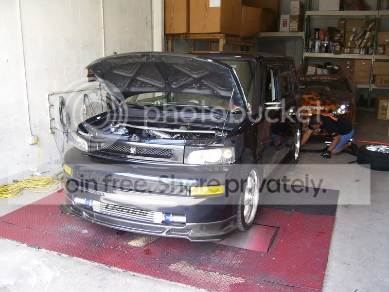

ok so got her on the dyno today and all in all i am pretty happy considering the problems ive had......
ok so baseline run we did nothing except put in the value for the new injectors and we came up with a 108.51hp and 100.20ft lbs at 5700
so then after tweaking and having lots of tuning issues because my knock sensor is bad and keep trying to make the car pull timing we came out with this...
at 7.5lbs of boost 155.45hp and 143.54 ft lbs at 5700
So all in all i am very happy with the results for now....once the knock sensor is replaced and the fuel rail and pump are done i will be gettin it tweaked. my tuner thinks we should have any problems hitting 180 with these things at 9lbs so we shall see what transpires in the next lil while...also i am looking into a water/meth kit in the near future and that will help me immensly

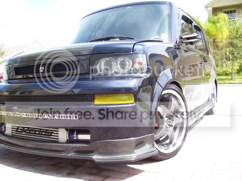

oh here are some fully completed pics.....now that the new wheels are on it and everything

very nice flows really well but i'm more of a stealth kind of guy rather than advertise the intercooler.
Old Mar 21, 2008 | 11:21 AM
Posts: 384
see i was the same way....however most everyone around knows my car and they know its boosted either by me telling them or by simply finding out when the box walks away...lol......so i figured might as well show it off and get some better airflow at the same time.
