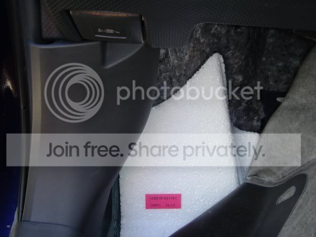

Under the carpet is Styrofoam.... :-/

lol! we're going to be using the styrofoam to brace ourselves on the track... oh yea... I'll hit up a few places to see what can be done. It's a bit ridiculous LOL! I had just assumed it was solid under there so my styrofoam is probably squished by now LOL!

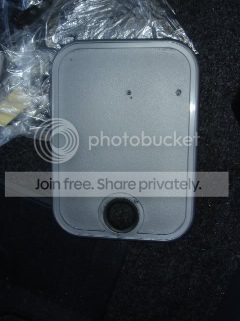

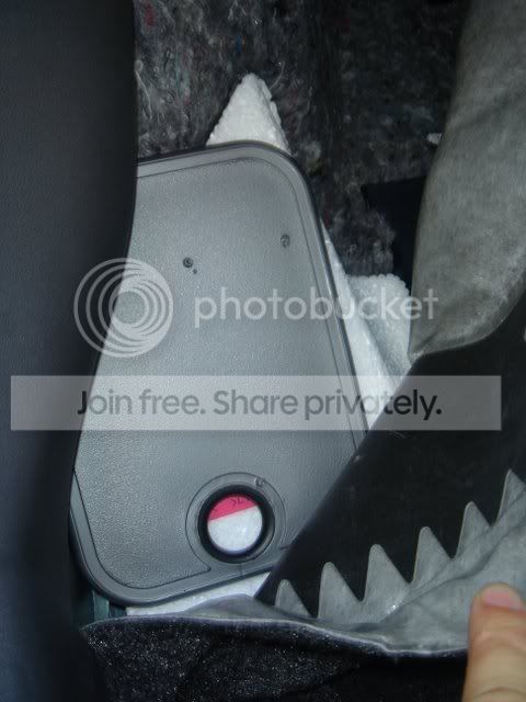

You don't really have to rip the carpet out, it kinda folds out. And I inserted a small synthetic panel(about the thickness of a pedal screw) between the styrofoam and the carpet to have something solid to screw the pedal into. Worked fine for me.

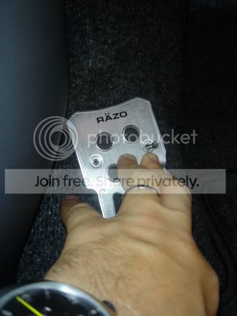

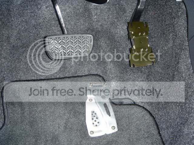

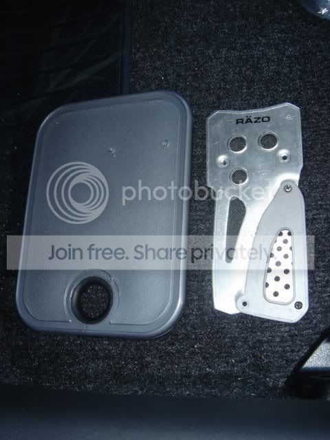

Default ok, here it goes ...
[/img]
The misterious object above is a mini cutting board with 2 layers - hard plastic (visible) and rubber on the other side.
Align the right edge of the plastic base with the right edge of the styrofoam and the bottom edge with the floor.
I didn't cut the pannel to exact size and glue it to the styrofoam, but you can. I just aligned it and put the carpet back in place on top of it.

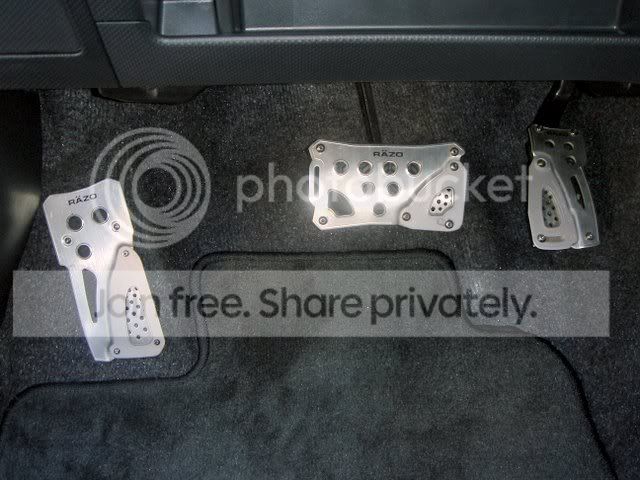

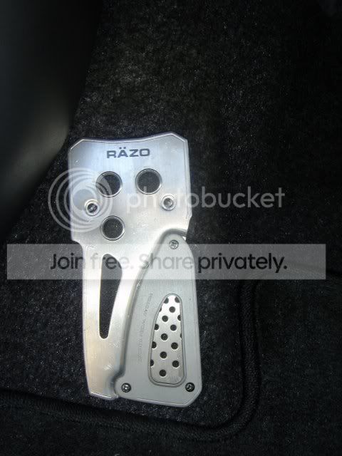

For the pedals install you won't need my instructions - Razo instructions are perfect.
Finished job ! The dark spots on the floormat is my sweat ))) It's very hot here ...
Oh, almost forgot. Here's the matching shift ****:

It is the second xD I've done it to. On the first one that area was filled with some synthetic material that appeared less fragile than the styrofoam in this one.
So, you'll have to see what you've got when you lift that carpet...

Wait you actually have Styrofoam under the carpet in your RS 1?? Wow.. that is just so.. cheap! Could it be that all the newer models, RS 1's and 09's, will being using styrofoam instead of the synthetic material for the padding?

Looks like that styrofoam was custom cut for the xD. Where'd you get that?
