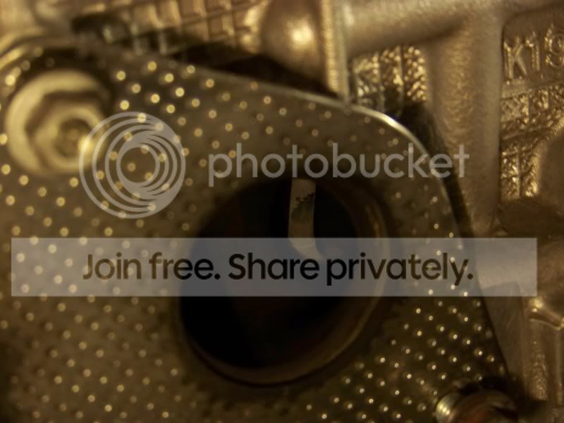

take off your header and look at your exhaust valves to be sure
then if the exhaust valves are bent then your intake are bent if not worse. bc of our vvt-i which opens the intake valves longer they would be more at risk for damage.
Dont assume they are bent til u take off your header and look at them. how bad was the money shift anyway? did u drop the clutch and it instantly revved to 8+k RPM?

if your exhaust valves look like that then buy a used head and start building it.
new valves
dual wound vale springs
retainers
seals
then stage 2 NA cams and tune
im prolly leaving some stuff out im rrly tired. :/

Originally Posted by Jwa11ace
I was going turbo this summer too... but not it looks like i might be going to a NA build
you can still turbo
now you can get your block built and your head get a balanced crank rods pistons sleeves and a built head and you'll be ready for turbo.
those pics are form the valves on my car.
