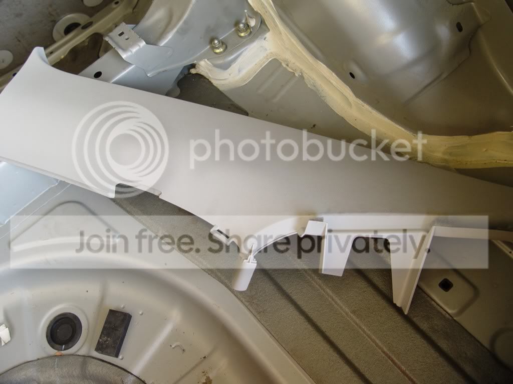

here some pics i took this morning, since its sunny out
as far as the install goes, its very easy,very basic.
must remove all interior panels around the rear seat belt assy.
this includes the trim piece that curves around the window as well
not many tools are needed
the last pic is the piece that you will need to trim (if u want to put back on) or else it will not fit on/around the bar.
