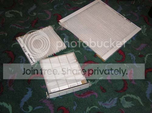

First off the AC evaporator is pretty small and it can get clogged with all sorts of dust and mold spores and get pretty nasty after a year or two and then the cooling efficiency drops and along with that your mileage and coolness on a hot day. Not to mention the funny smells that can come out of it when it gets damp.
2005 xB came with it installed from what I hear and then the 2006 they left them out.

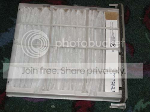

I made one for my xB from a $3.00 hot air filter - not quite a hepa but pretty good - actually I got three out of it - it took more than 10 minutes to do it however - cut them up with some heavy duty sissors and then folded it up to make it pleated to increase the surface area then silicone sealed it into the tray. I still didn't do the second filter element on the outside of the heater box however that filters the recirculated air. May make a trip back to AutoZone and see if they got any Bosch filters in yet - they list one for the xB but didn't have any in stock yet.

FWIW, I cut those paper borders and Xs off of mine...it will just restrict the airflow.

there is no part number. Most of us went to Home Depot to pick up a 1 inch thick air filter. Then we cut them down to size.
