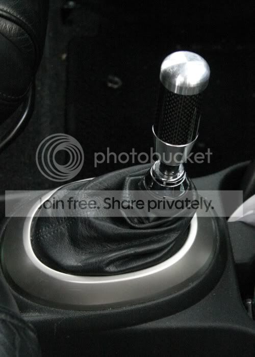

Old Mar 11, 2006 | 09:31 AM
bbdude's Avatar
Joined: Aug 2003
Posts: 105
any automatic **** will work if u move the o/d switch.
i moved the switch next to fog light switch.
and i bought scion OEM shift bootfor mannual tranny from dealer
and flipped over the chrome finisher and make the hole bigger with drill.
i really look clean and nice.

Can you post pics? I dont understand what your saying about the flipped over the chrome finisher...
Old Mar 11, 2006 | 05:26 PM
bbdude's Avatar
Joined: Aug 2003
Posts: 105
don't really know hot to post a pic.
but there is chrome finisher with OEM boots as well.
and there is a ring to hold the finisher in place inside the boot.
take that ring off and then turn the finisher upside down and then put the ring back.

got pics posted
these are pics of my shifter.
Old Mar 13, 2006 | 01:23 AM
SmokingTires's Avatar
Posts: 681
From: San Francisco, CA
Damn that looks nice! Did you just keep the button permanently depressed?

whole **** should be pushed down when shifting.
