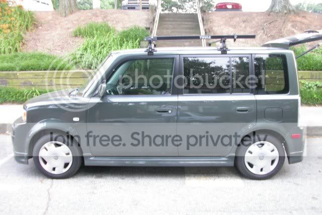

I installed the Thule roof rack last night. 58 inch load bars with #400 feet and the #2124 Fit kit. It fit perfectly, and seems very sturdy. The Xb has a huge roof space. I could fit a half dozen bikes on there.
I could not get the front fairing to fit to my satisfaction, so I have left it off for now. I don't know if I'll need it, with the steep front windshield. On my last car it helped reduce wind noise to a tolerable level, but I don't yet know if that will be an issue.

OK. Here you go!

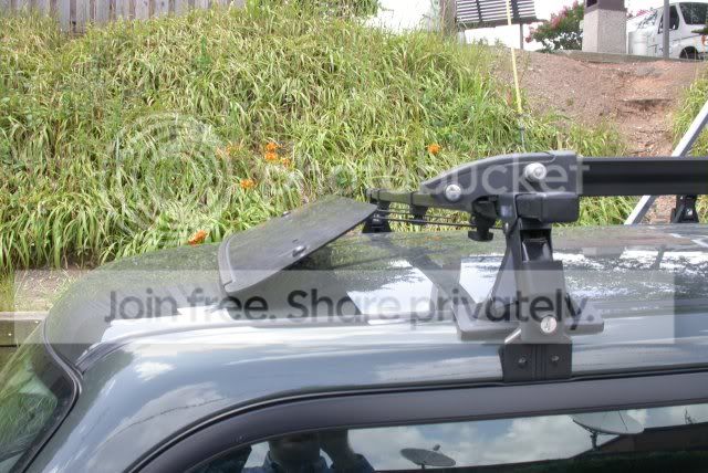

2. There are some tweaks that can be done with a Fairing to improve the
fit. First the 2 outboard clamps can be moved farther inboard. This will
increase the curve. You can also move the "bars" on the outboard brackets
attached to the shield to the rear slots on the bar clamp which will also
increase curve and pitch allowing the Fairing's feet to hug the roof
tighter.

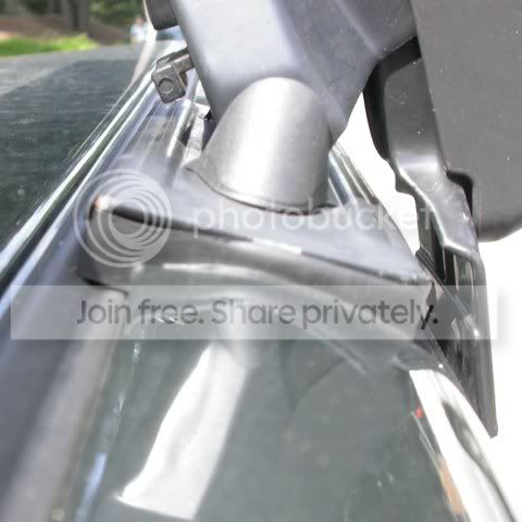

Anyway, I think I may have made a mistake by mounting the fit pads so they hook onto the inner edge of the rain guard and not the outer most lip. Am I right in my assumption? Also, I ordered the fairing but you said you had trouble with it fitting. What was the trouble? Another question: does it matter how far back I put the rack as long as the two load bars are atleast 27" apart?

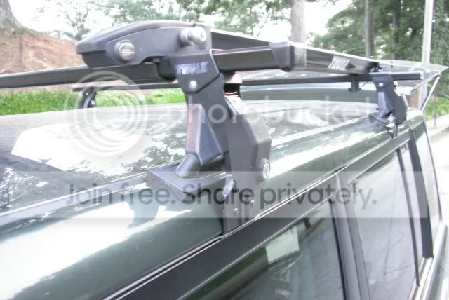

You definitely want to fit the feet on the outer edge of the rain guard. If you do, it fits quite well:
The rack was a bit noisy (whistling) without the fairing, so I went ahead and put it on. I don't think that it's the way the Thule people say it should fit, but I like it this way:
