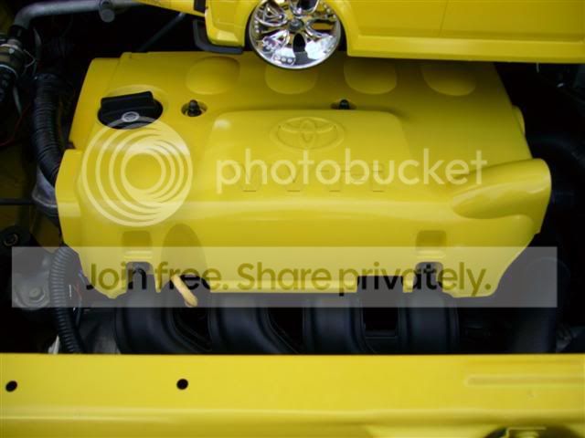

I painted mine with John Deere Yellow paint from Tractor Supply store. It matches very well. Also painted my RC cars with it. Just wash the cover with soap and water, after removing it. Let dry good and spray on 2 light coats of automotive primer. Then followed with 3 light coats of John Deere Yellow. I am going to put Carbon fiber vinal lettering and logo on it.

I think there's a John Deere store near my house. They sell the paint there? Or where else can I get it?

The store I found my paint at is called Tractor Supply. It carries farm and animal needs. I use the spray can type. Saftey Yellow is also close, can't remember the brand. Might check a local hardware store.
