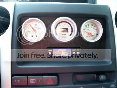

Well if you have a aftermarket radio and feel like relocating it to the pocket underneath the climate controls I can send you a 3 gauge holder.. That I custom made.. you would just need to pay for shipping.. Here is a couple of pics of it. Just figured I offer it up to you..

Sold!!! That's great... saves me from miss-drilling the dash. And it gives me a reason to radio down below ( been looking for one, but didn't want one of those 7" screens next to the others, too expensive). Shoot me an email and I'll get with you.
