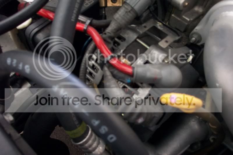

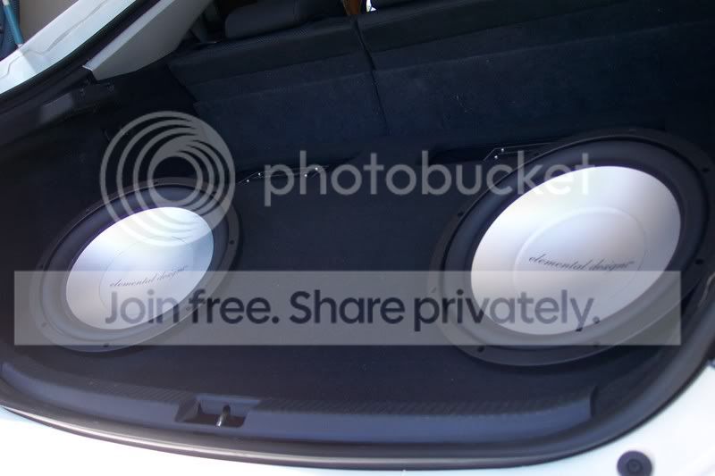

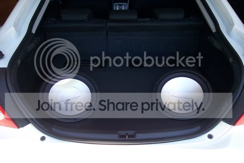

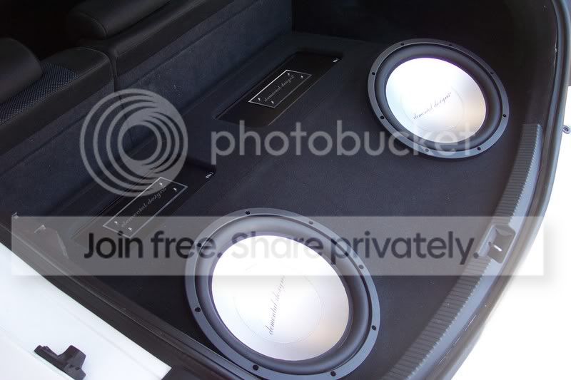

you guys might remember my old system, all done up in eclipse.

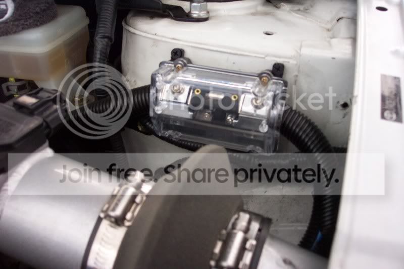

i wasnt happy with the sound of that setup, so i sold it all and went elemental designs. i got rid of my cap, no real use for it. with this set up i redid all my wiring. ran 0 gauge to the amps, and ran 12guage twisted wire to my front components. also did my big 3 in 4 gauge. between the speakers there is a pretty big empty space. im thinking of doing a molded painted piece, with a 7 or 8 inch screen in it.
i have the 2 6500s being pushed by a nine.2 amp.
the 2 12" 130v2s run at 1ohm by a nine.1 1200w amp
im very happy with this setup, it sounds great. here are some pics
0 gauge fuse holder
trunk
my alternator wire

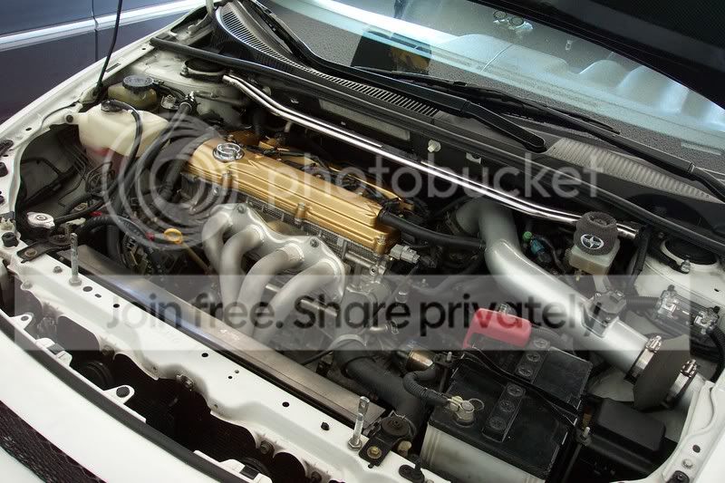

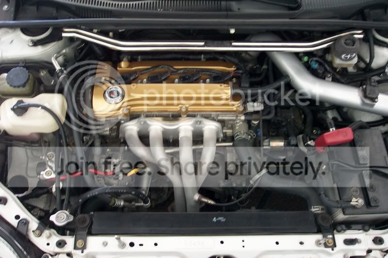

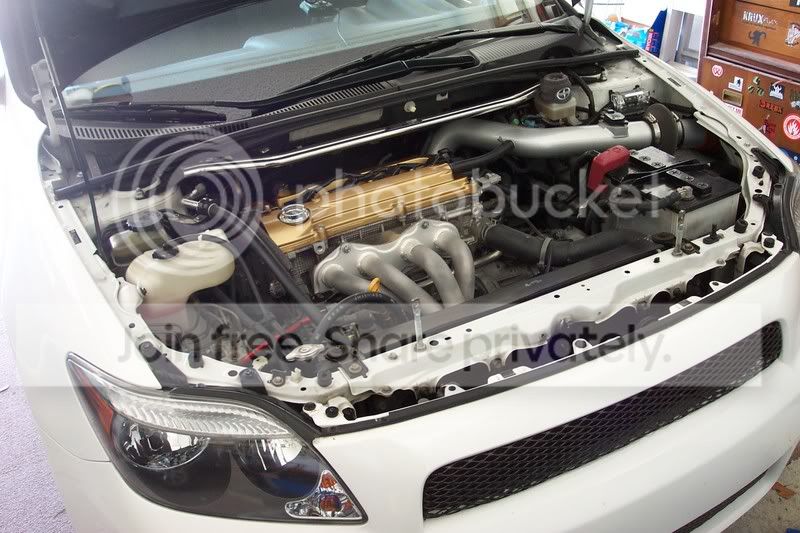

couple engine bay shots with my newly painted valve cover
matches my gold calipers

im not much for sound systems, but thats a nice valve cover.

That system is beautiful haha.

WOW!!! eD looks 10x better than ur eclipse setup. ME LIKE

Very nice and clean. I like it alot.

love the eD. what paint did you use for the valve cover. THat like perfectly matches my rims.

its just the dupli color high temp paint. you gotta prep the valve cover good. i took it off, and cleaned it with de-greaser. then scrubbed the whole thing with steel wool. my vc used to be polished so it wasnt hard to get it clean. after that paint it give it a few coats, let it dry and put it back on.
just gotta be careful putting it on as it can get chipped and scratched. not as nice as powdercoating, but it works.

yeah i know about the prep work i just didn't know what kinda paint you got.

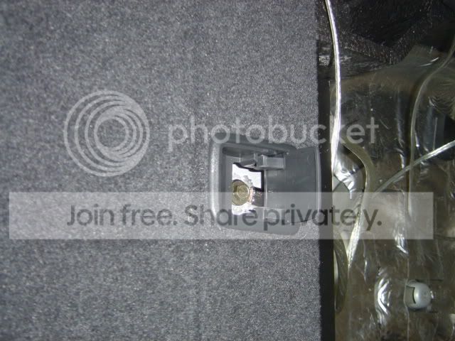

With the engine cranking, i'm sitting at 14.2 volts according to the battery terminal I have with a volt meter built in. I honestly have no idea what i've done wrong. It may be the ground in the trunk. I have it grounded where that hook used to be. From there it goes into a distro block unfused, and into my two amps, which draw 360 and 600 watts respectively.
Neo, any wire i've added to my car has had the contact point sanded down.
If I could get my headlights to not dim, and my entire car to stop rattling like a beater, i'd be a happy camper.

looks like a pretty good ground to me. i had bad headlight dim before going hids, i guess there really isnt any thing to solve it. get some hids!!

meh thats an ok ground. i actually did one of the bolts that holds the rear seats on. that seems to work pretty well.
