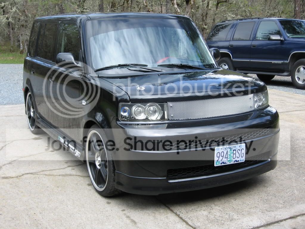

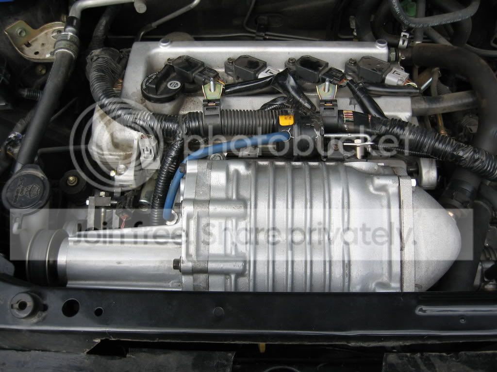

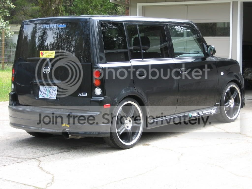

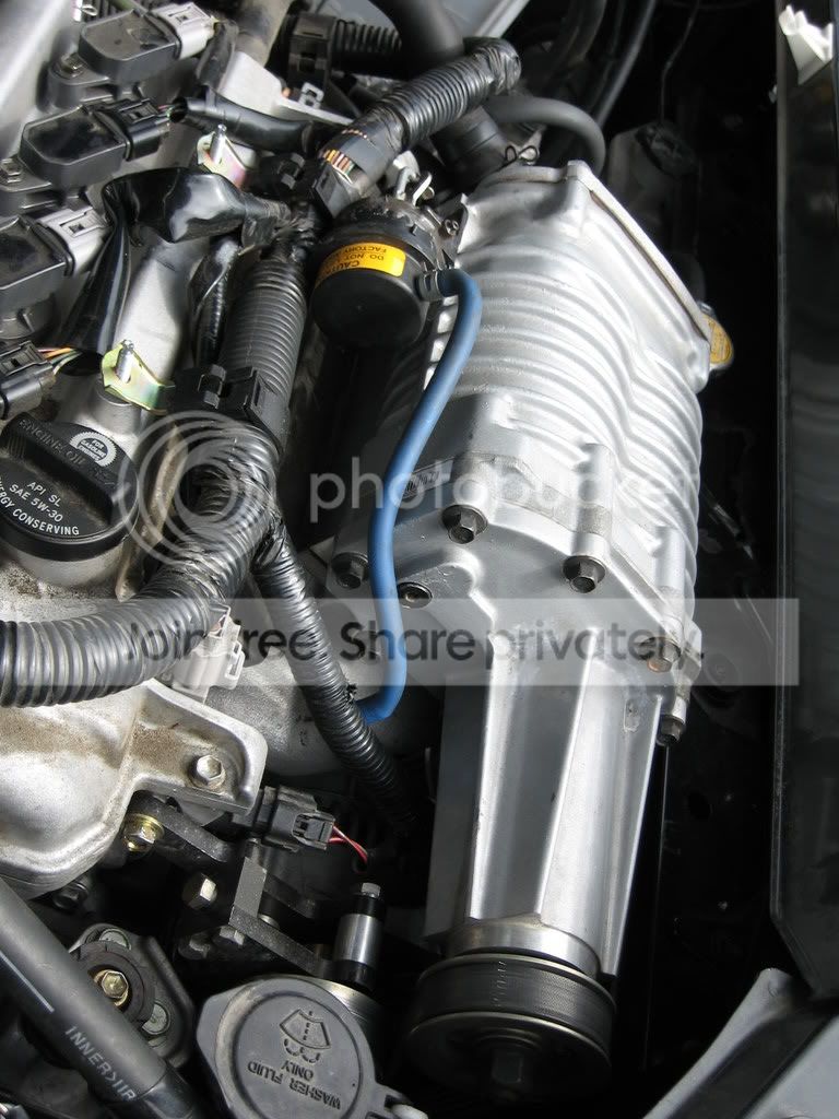

K, here is some pics i took really quick while it stopped raining...

wow, i didnt realize how dirty my engine bay was until just now... guess i need to go clean it. if anyone wants any close up pics of anything inparticular, let me know and i will see what i can do... hopefully some time today i will be able to take a video of a 0-60 run and post it...

Hell yes... what all is involved with the s/c install?
Old Apr 17, 2007 | 08:55 PM
EasysBox's Avatar
Posts: 548
From: Bremerton,WA
it wasnt too bad, just a little time consuming, the biggest problem i had was removing the alternator, i really wish that they had used a tension pulley, i had to remove the bumper and the winshield washer fluid reservoir to and use an impact gun to remove the bottom bolt of the alternator, it was on there just as tight as the crank pulley was. other than that the install is pretty straight forward, it is a pain to get the belts back on, but yeah, it makes it easy if you are good with your fingers, it is really tight bolting the new intake manifold onto the head with the S/C installed, it just takes patience. the emanage was a peice of cake though, took me 5 mins to install that.

the blitz sc remounts the alternator upside down and further forward. is that the case with the greddy?
did you have to move your AC lines at all?
i need help regarding my AC lines:
https://www.scionlife.com/forums/viewtopic.php?t=171931
thanks
Old Apr 22, 2007 | 02:26 AM
EasysBox's Avatar
Posts: 548
From: Bremerton,WA
i didnt have to move my alternator at all in that respect, it mounted in the factory location. the only thing i did with my ac line was zip tie it out of the way. really quick and easy and i didnt have to fab a new line which was cool. the only thing that is changed about the alternator is that the factory bracket on top is replaced with the GReddy one which has the SC belt tension pulley on it. really easy. if you have any more questions please feel free to ask... i am still working on a video, but it has been raining here the past few days. the tires have been spinning like crazy on the wet pavement, so as soon as it dries out ill make a vid and post it.
