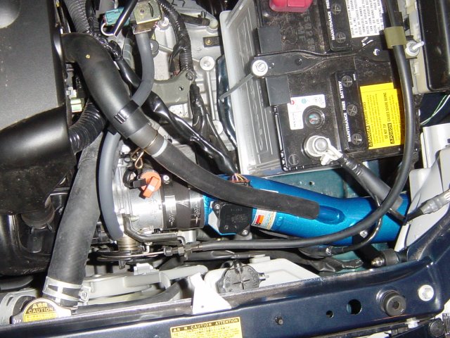

I just installed a K&N Cold Air Intake in my Scion xB. Below is the review that I posted in the Parts section of Scion Life. I'm also including a couple pictures of the finished product. Enjoy.

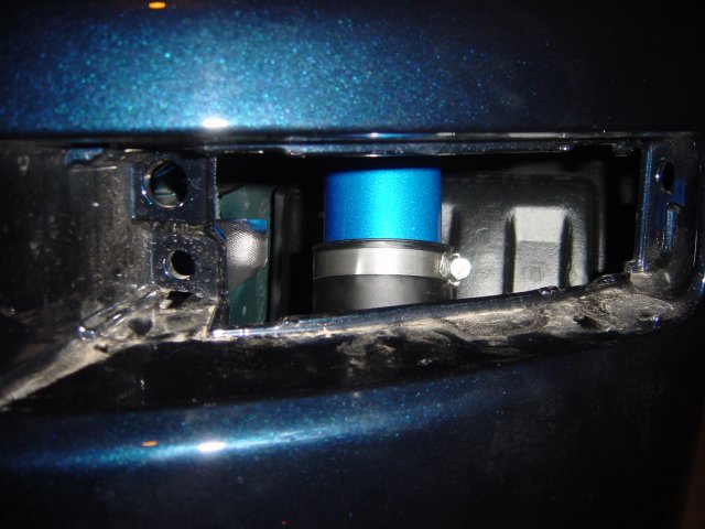

Speaking of the filter installation, one tip I can offer to make the job easier is to remove the foglamp hole cover (only on xB's without foglamps) to gain easy access to the clamp through the foglamp hole. If you have a foglamp in the way, and don't want to remove it, then you can still get to the clamp from the under-side, but it will be a lot more difficult.

Finished Installation:
Access to Filter Clamp through Fog Lamp Hole:
