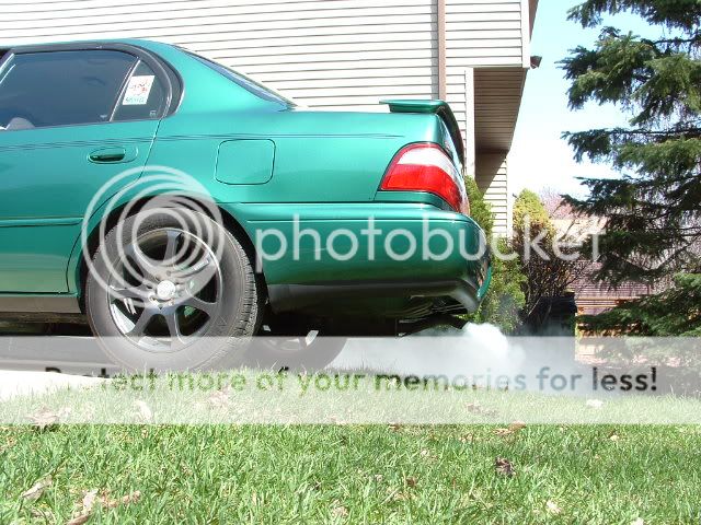

one word: seafoam.
run it through the brake booster or pcv valve, have it choke the engine and let it stall it out. let it sit for 5 mins. then start up your car....the smoke is half of the fun!
i've done it to a couple of my cars, it will never touch my tC, because i'm too scared of messing up the crazy stupid sensors they have on the intake (seafoam is 02 sensor safe and cat convertor sensor safe). you notice an immediate difference in accelleration, quieter idle, etc. you can also put it in your gas tank for a fuel injector cleaning, like you would get from stp. also, i like to put some in the engine oil, run the car for a few minutes, then drain the oil and refill with fresh oil.

err, how does running that stuff through the brake booster allow that into the internals?? Last I checked, the brake system and the combustion cycle/components were seperate systems.
From the pic and description, it looks a lot like the stuff called Top Engine cleaner, that you can get from any GM dealer. It's an aersol based that you spray directly into the Throttle body.
Similar priniciple, start the car, spray into the TB almost to the point of staling the car out, and as it sputters, apply throttle, repeating the process until the can is gone. Let it sit for about 20-30 minutes, and then start it up and rev it out, lots of smoke.
Again, this is typically *only* recommended for cars with high mileage, and lots of carbon build up in the head.

you disconnect the brake booster hose from the brake booster, the other end of the hose runs into the engine head to get a vaccum. i'm pretty sure you can also put it in the throttle body, but it's not aerosol, so that could be difficult
