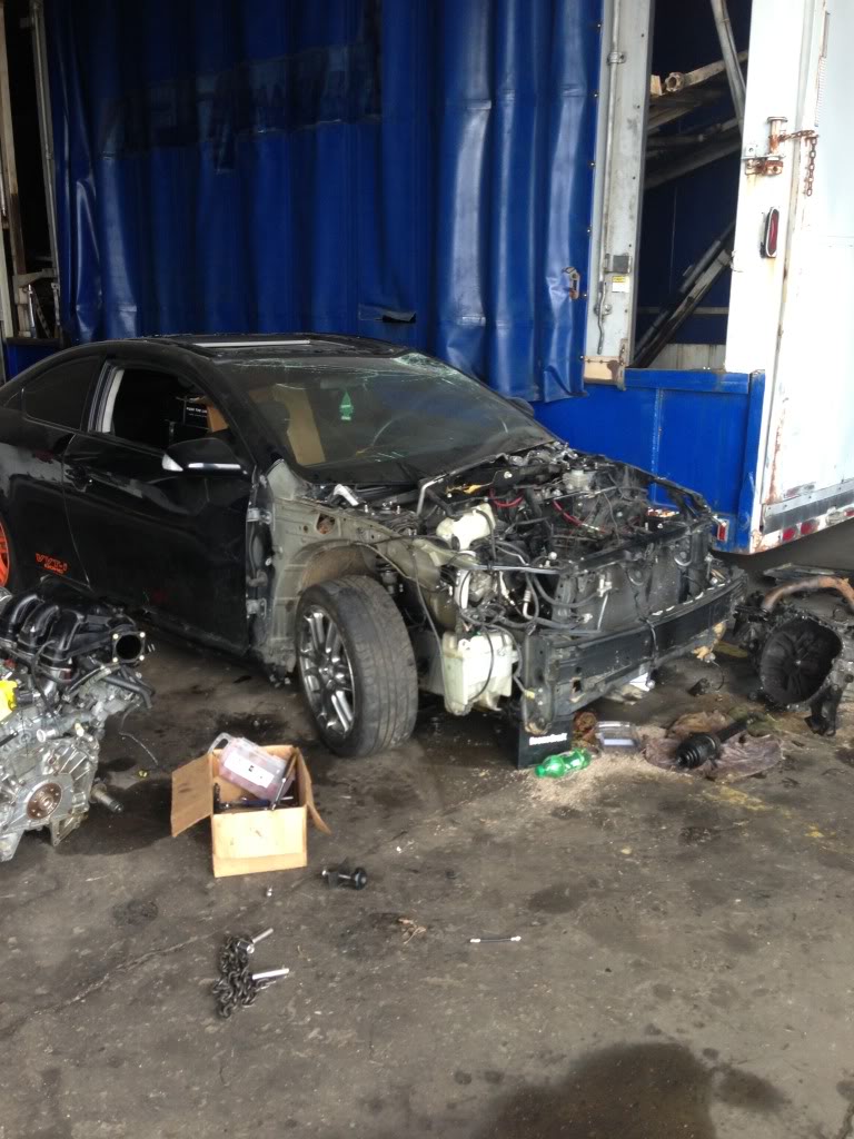

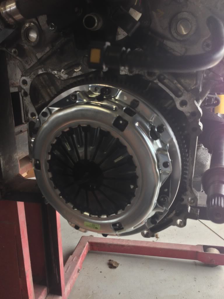

Talking 2GR-FE Swap Update - Pics
Yo, haven't been on here in a bit! Decided to take a shot in the dark and start the swap last month. After I rolled the car I drove it about 40 miles (with proper escort vehicles) to a warehouse a buddy of mine let me use and it still drove better than ever! Dropped the engine out there and finally got it moved to a friends shop where I could get the real work done. Engine and accessories came out of a Lexus ES350 and fit surprisingly well. Did a 5-Speed swap on this car last year using the e351 transmission. So far I've got the engine and transmission mounted. Still working on the RH Motor mount, ECU and Wiring.
