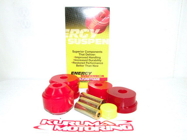

So I was looking into motor mounts, then I saw the inserts. I don't get it.
Is it the same thing? Stock pictures just looked different.

The difference between the GGP and the Energy Suspensions from what I've read was that Energy Suspensions you need a press to put the metals inserts into the mounts.
GGP basically charges $80 more to do that for you.
These are mounts.
These are inserts:

The inserts are held in with pressure and those zip-tie looking things. The mounts replace the entire stock bushing and are held in with the factory engine and transmission mount bolts and need to be pressed in with a hydraulic press.
IMO I'd just used window weld to fill the stock mounts and save for the full bushing replacements further down the road. Although looking at how much is involved in getting to the rear motor mount I might be tempted just to replace it with ES parts while its out.

the inserts go over the stock rubber, the "mounts" replace the stock rubber
