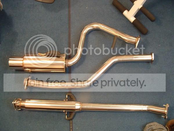

I got my Tsudo N1 exhaust exactly one week after I placed the order through. Great service from Speed Element, and great shipping. Hey hey, lookie at the beauty.

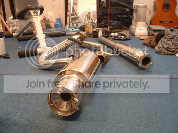

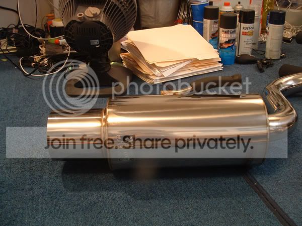

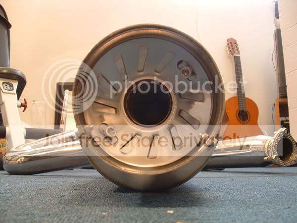

This is the canister. Pretty large, and oh so shiny!

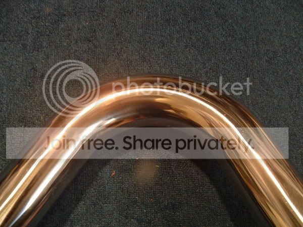

Look at the mandrel bent pipes. Sweet! No jaggies! The weldings were excellent.

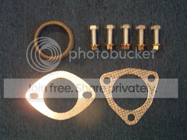

These are the things it came with. 5 bolts and nuts, two flat gaskets and one metal cone one.

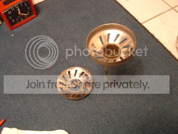

Here is the tip with the ugly silencer. I wanted it off the second I saw it. All it took was a claw hammer and some fineness. It’s hammer time! No WD-40 used. (Oh snap!)

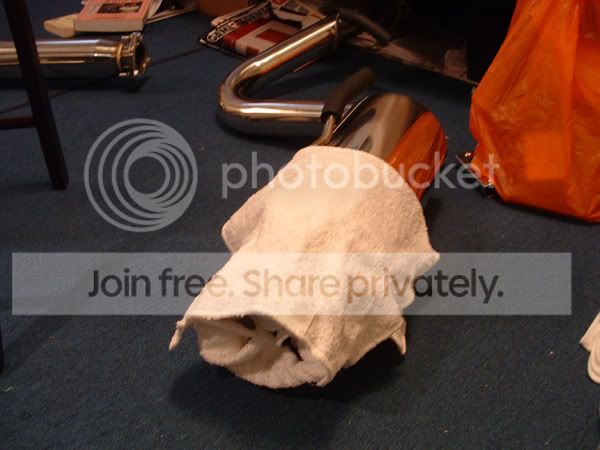

Got to wrap the tip before installing. I’ve read another thread that during installation, it can scratch the bumper.

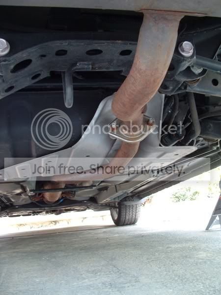

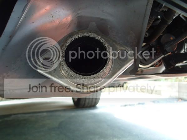

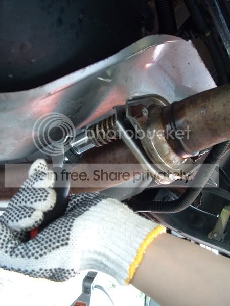

I’ve decided to not install the midpipe, because other peeps here said it would be too loud. And I’ll only need a 2.5 inch midpipe if I’m going turbo. So on to using the stock midpipe and just getting the Axelback on. Here is the joint we have to… um… dis-joint. Spring bolts. Boing boing?

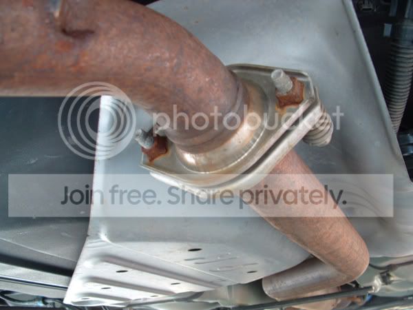

The nuts for these spring bolts ARE welded onto the stock axel back, and with the magical WD-40 and some flexing of muscles, the bolts pops right off. Yoink.

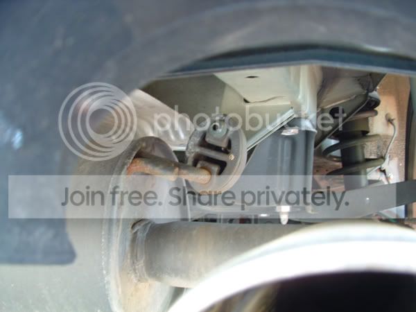

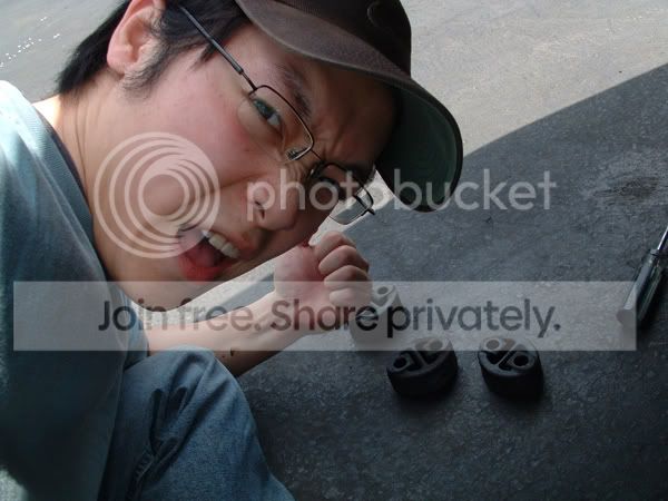

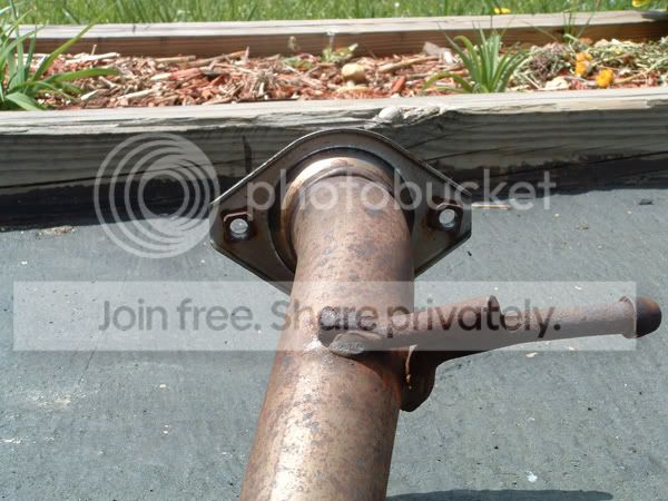

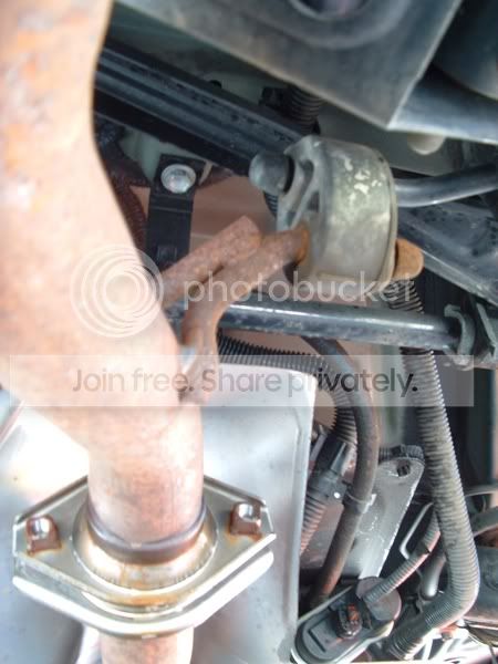

There are three rubber hanger things that we have to get off. Only two needed for the Tsudo Axelback to mount on. Here are the three. (one was hiding from me on the left side)

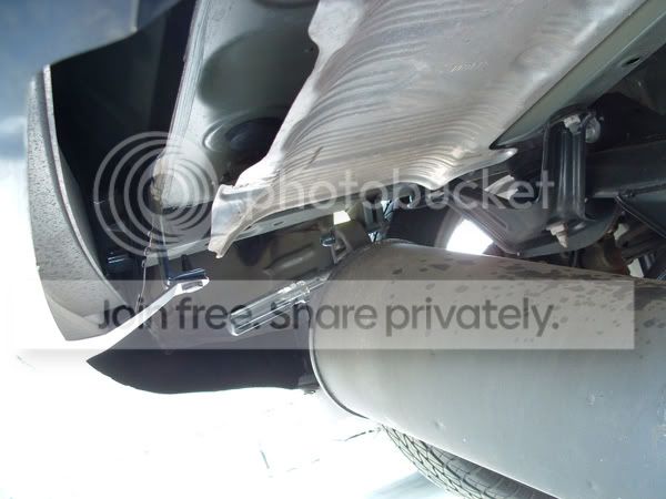

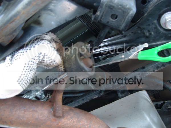

The hardest part of this whole thing was getting these bastards off. Your best friend WILL be the WD-40. Take a flat head, jam it between the metal and the rubber, stick the WD-40 plastic straw in and spray like a girl with a small bladder at a beer party.
Here I used a screwdriver and a pair of scissors to part the rubber hole and yank off. (took me a while to figure this out)

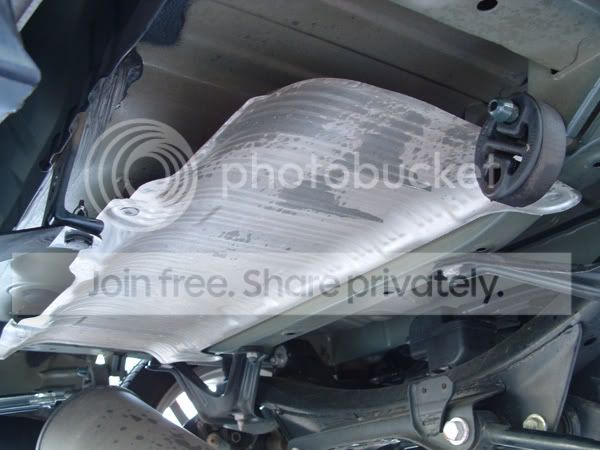

Did I mention the importance of workgloves? I’ve read someone here got a giant cut from the heatshield. THIS heatshield, is deadly.
Rubber hangers finally off. I hate them!!!

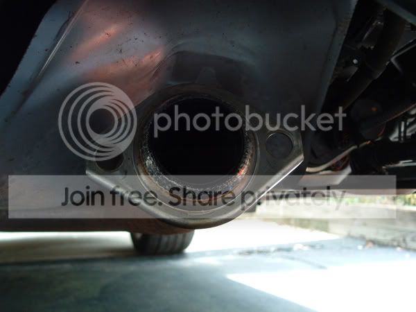

Here are the welded nuts on the stock. Can’t use them! And in turn, can’t use the spring bolts because I’ve tried screwing the Tsudo nuts onto the spring bolts and are different thread. So got to use the tsudo nuts AND Tsudo bolts.

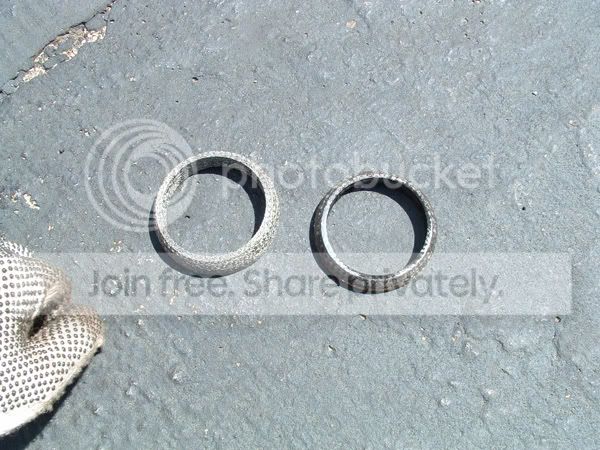

Here is the stock cone on the right and Tsudo cone on the left. Tsudo come is a little larger in diameter and a little taller in depth.
Here’s how they fit on the stock midpipe. First is the stock cone that fits flush and the second is the Tsudo one leaves a little space on the bottom.
I was just about to use the stock ones as someone suggested here (so no leak) but ended up using the Tsudo one because it didn’t feel like the stock ones had enough depth to seal the stock midpipe and the tsudo axelback when I tried to put them together. So pop on the cone, put the tsudo on the two hangers (friend holding it up), line up the midpipe and the axelback and put the nut and bolts on, and tighten like Meg Ryan’s face lift.

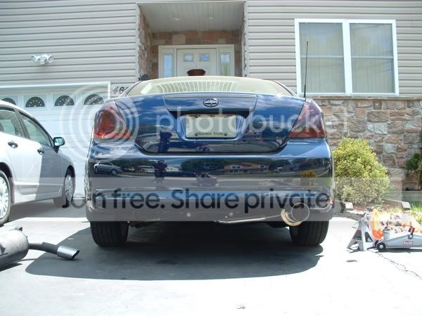

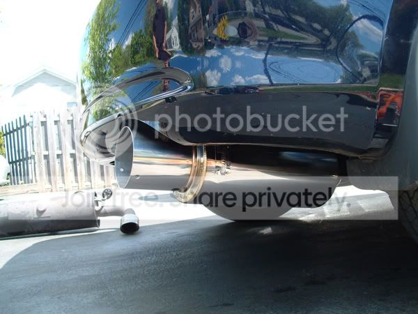

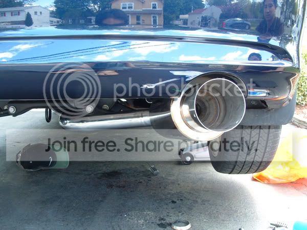

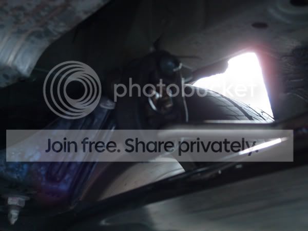

The exhaust after everything was touching the bumper, Oh no! Possible melting like the wicked witch? Solution? Someone suggested here to pop something in between the middle of the rubber hanger to make it longer, ghetto way, but that’s what I did. (buying a 4 inch hanger I think will make the exhaust too low. Get one from Pepboys that’s 3.00 - 3.25 inch hole-to-hole if you have the cash) Perfect!
Lowered back down, check your bumper-exhaust clearance, start your engines, rev, and enjoy.
I am real satisfied with this exhaust. Installation was at around 2 hours (because of figuring out the rubber hangers) Deep tone and not a can of bees, looks aggressive, no rasp and no sputter, no rattles, checked with hand and no leaks, not too loud. Just remember to wear protective gloves and goggles(rust will get in your eye and you will cry like a baby) I didn’t lose much low end power because I believe I kept the stock midpipe, drove around the neighborhood and sound drops to nothing when let off the gas or at stop light, on the highway above 55MPH it quiets down to a purr. Meow. I love this pipe so much that I want to kiss it hug it and shove my… ok, I’ll keep it PG-13. Lol.

ok that thing in the middle of the rubber hanger worked great for me for sometime, after the turbo install, it started to hit the bumper.. maybe some more movement plus the new downpipe/spipe to replace the stock.. even with longer and tougher hanger it still move up with the hanger moving from vertical to horizontal position and hit the bumper.. i had it a metal welded from the hanger to the car itself, worked great but excess vibration is a lot.. anyone had this issue

mine is horrible... i have the dc sport headers and an aftermarket s-pipe and i think its throwing it off line cause mine rubs the bumper so much it melted it. so i bought a new hanger for the canister and it didnt help. i ended up taking off the hanger for the axelback and used the longer hanger for the canister. and i used zip ties to hold where the axel back is in place. it hangs so low now that i had to take off that metal plate in the middle of the car cause it was scaping it bad. i might put the stock headers back on or something i dont know yet,

I did the same install las weekend and I used two pieces of wood in between the rubber hangers just so it wouldn't touch my bumper.
