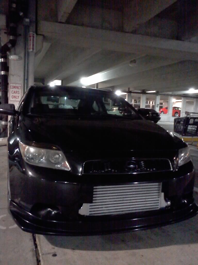

pictures or this is all fake

Lets see some pics, I gotta see this 422whp bolt on

X2 on pics

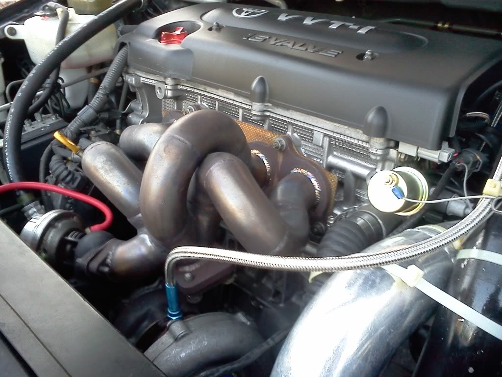

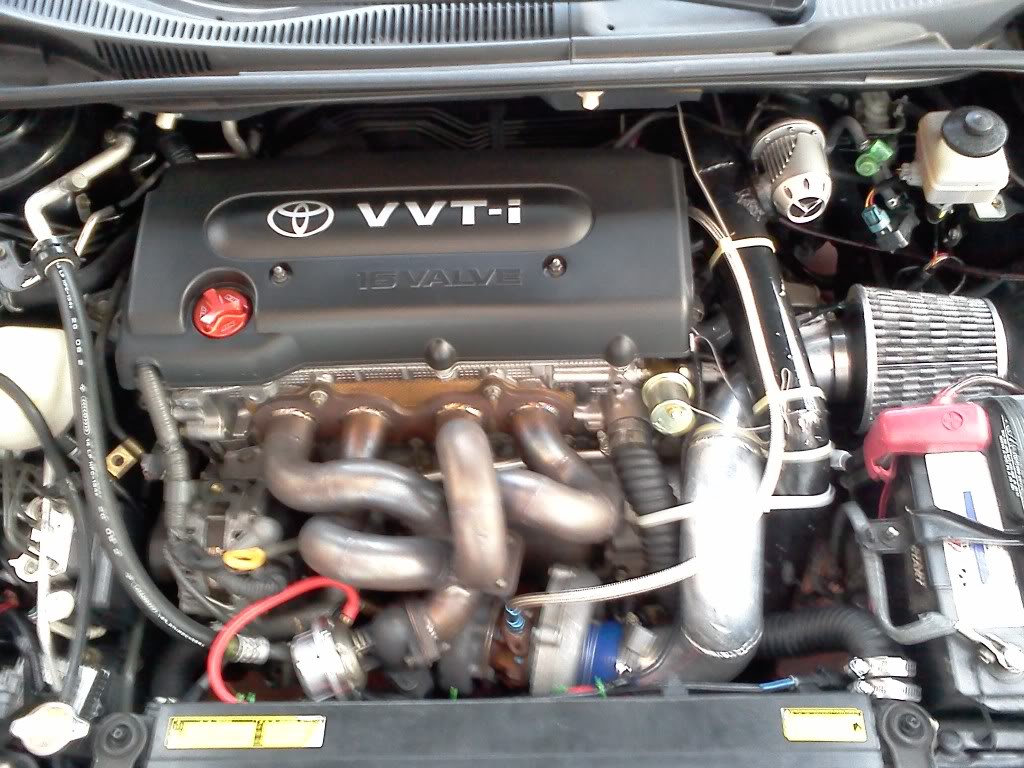

wheres your oil feed line going?
Old Apr 1, 2011 | 04:07 AM
Boostin26's Avatar
Joined: Mar 2011
Posts: 19
Its wrapped around going back,hard to see in the pic.
Old Apr 1, 2011 | 04:38 AM
trd07tc's Avatar
iTrader: (-1)
Joined: Aug 2009
Posts: 1,940
From: Milton
I see that. Where does it go after that? Oil filter?
Old Apr 1, 2011 | 08:27 PM
Boostin26's Avatar
Joined: Mar 2011
Posts: 19
No I placed a T fitting so it could flow from the head to the return line and the oil pressure guage.
