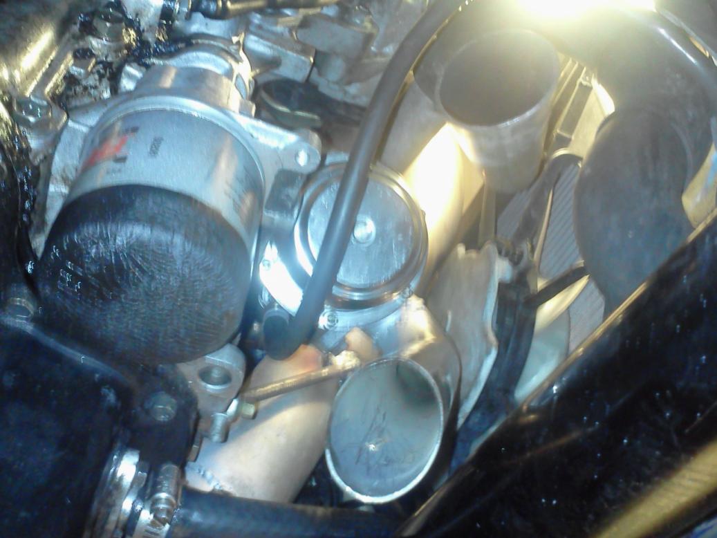

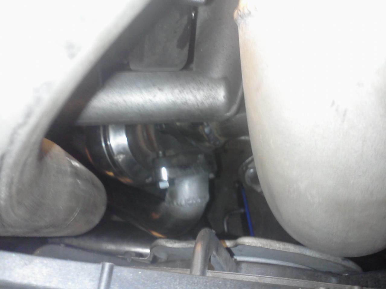

Dual Gates are on I will post pic tomorrow I have to run a vacuum line to the new lower gate so I haven't hit boost yet to see how it works. The shop did a awesome job on adding a extra runner to the manifold

Sorry the pic are not the best its in a really hard spot to get a pic of
