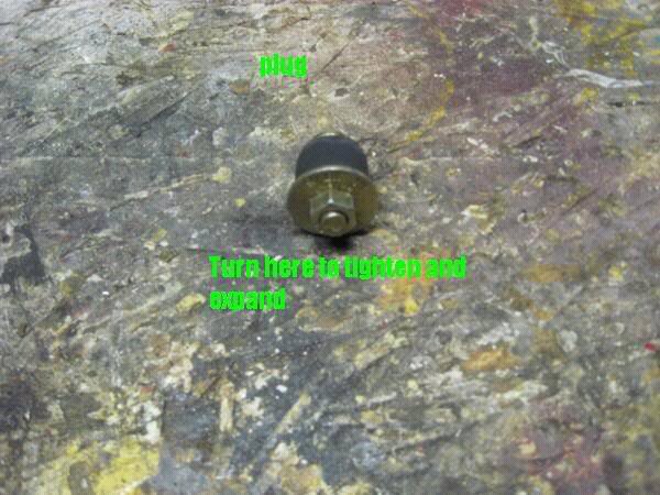

alright so what did you guys use to plug the inlet where the recirculating air goes?

Piece of the rubber hose with a plug for got witch plug I used I got it at home depot in the plumbing section. and clamp.

That's the best pic I can find. And sorry for double posting.

are there different sizes? what size do i need?

Just take the hose with u and test it out sorry I forgot what I used and it's a pain to take apart. I pmed u a site that shows u how to install one.
