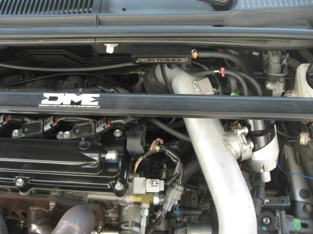

Pic of MAF location?

i dont understand how thats possible unless your maf is RIGHT against your BoV. if it isnt far enough away it will get false readings.

If it is in a bend, too close to a bend or there is something like that flexible dryer hose before the MAF, all of these can cause turbulence.

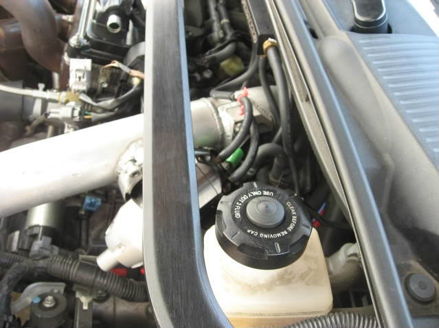

The pic is bad with the strut bar in the way, sorry.

General guess on how far it is from the bov is about 2-3 inches I want to say.

i agree w mike on that one. placement of everything seems to look ok. altho general rule of thumb is that the bov and maf need to be around 6" away from each other.

maf is super close for sure.
