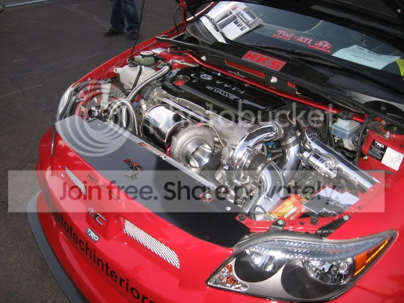

***note*** turbo manifold with turbo and.....is.....that.....yes a supercharger as well...I would have never guessed that could ever happen

so you get the turbo custom or kit... then 300+ estimated hp with a good tune, add the supercharger ***for low end boost and reduced turbo lag*** both at low boost combined why not expect to see impressive numbers

wow problem one is the s/c has more lag than most turbos put on the tc's the amount of money that took to do that setup was isane and that car was suposed to be 700whp but if i recall it only put down like 290whp i know that car was on ebay awhile back for like 20,000 its was a show setup only

Twin-charging with the TRD supercharger most likely will not produce any gains. The s/c will restrict the air flow that the turbo will produce. Twin turbo would work a lot better since turbos can spin freely (compared to a supercharger that spins off of the crank pulley).

Originally Posted by jbush09
I guess I don't know what I'm talking about
http://i110.photobucket.com/albums/n...nchargedtc.jpg
No one got the correlation between your first post and twin-charging.
...could i put the charger in the turbo's place and expect the same results?? As far as I know that trd supercharger can hold up to 400+hp from the vortech background it has. is this at all possible to have that done???
Sounds like you want to build up a turbo setup, then remove the turbo and put the supercharger in it's place. Doesn't sound like twin-charging.
Besides, in order to get the s/c to spin fast enough to produce that amount of power, you would have to modify a lot of things, considering there is no way to make a s/c pulley small enough, nor make the crank pulley larger due to clearance. You would have to make a custom multi-pulley setup with an additional belt.
Not a great pic, but you see the extra pulley and belt to drive the s/c.

I remember someone doing both turbo and supercharger. The money spent on that car was obscene, and the results were not worth it at all. I think it didnt even hit 300 whp.
