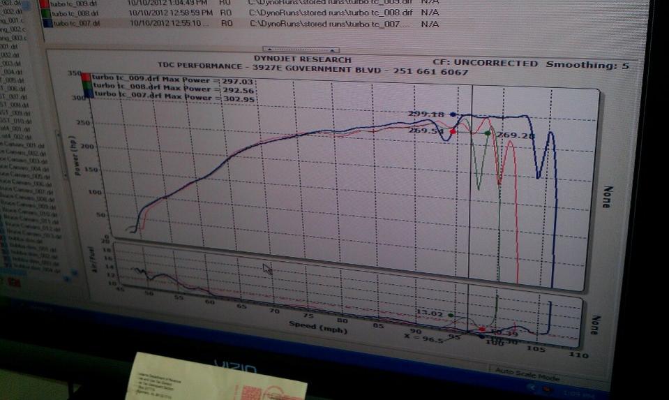

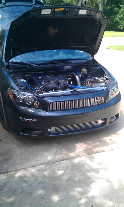

So, I have a 2006 Scion tC with built bottom end, stock head, custom blow through turbo setup running 13 psi and the AEM FIC. I just got my tune today at TDC Performance in Mobile, AL. and it made 303hp and 306tq at 5900rpm in a few different gears. Everything ran fine on the dyno, boosted smooth, no stumbles or misses or anything other than a weird hiccup around 5900rpm consistently (dont know if thats an issue). After we finalized the tune, we took it down the street to make sure everything was good to go and everytime you try to ease into the throttle and sometimes when floored the car would stumble, miss and sometimes run pig rich 10AFR. Sometimes we were able to completely let off the throttle and punch it after this happens and it would boost perfect like it did on the Dyno. Prior to the Dyno I had installed a brand new primary 02 sensor and new MAF sensor. I was wondering if anybody has had this problem or how I may go about solving this issue? Anymore questions or info needed about setup, let me know, thanks.

resistor mod for the aem fic search it, thats the cause for your hiccup

Yeah, I thought it might need the resistor mod but I thought the issues without were a lot more prominent, not just a little blip at 5900? I guess it won't hurt in doing it anyway but any ideas as to why car ran great on Dyno and crappy on the street with the same tune? Like I said, we did 3rd and 4th gear pulls WOT and easing into it and it ran beautifully.
