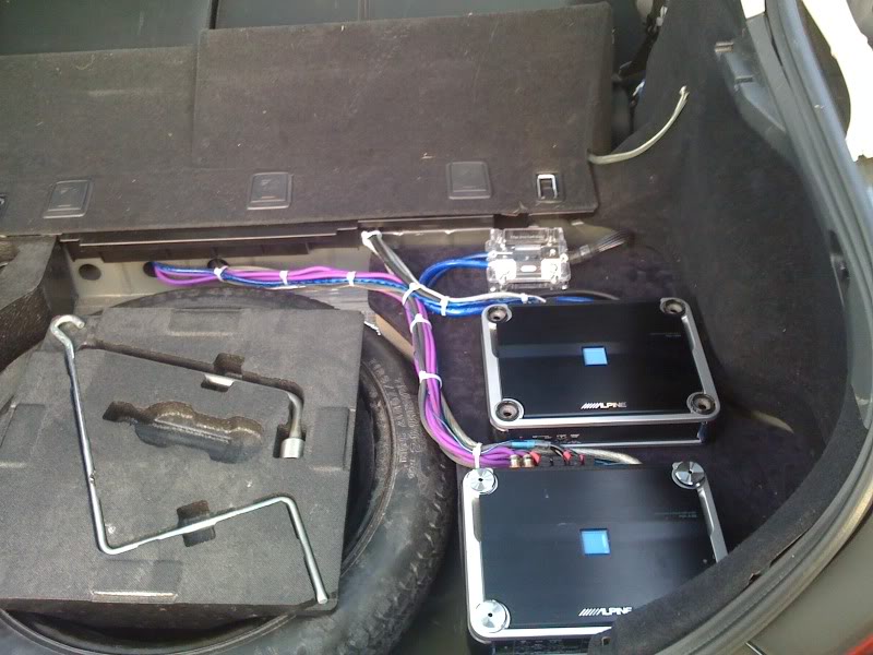

Old Jul 12, 2010 | 06:56 PM

I've got a 4 channel amp wedged into the space that b52hDUNN is showing. I had to take a knife and cut away some of the foam on the spare tire side.
I made another small cut in the foam on the rear bumper side so that my computer would also fit in that same compartment. It's about as good of a place as you'll be able to find without making a rack.
Originally Posted by jeremyyy7
the amp doesn't overheat in there
Mine never has.

I had it in the same place as the pic above but the amp did get distorted a little bit not sure if it was from the heat or putting something on top of it.

I have my 2 channel (Clarion DPX 1000.2) AND 4 channel amps (Dual XPA 4100) mounted on the right hand side of the spare tire. I had to orient them in a / / type of way but they fit well and are both what I would call full sized amps. You need to custom cut out the foam tray (but leave some of the vertical supports) to act as bracing so that when you put everything back together you can use the space above the amp for cargo storage without everything collapsing on your amps.
I've had no overheating or distortion problems in that location and I live in the 808 state (HI). although the grounding point has some soft hissing in the rear speakers from my 4 channel (but it could be bc of the junk brand amp) =/

i've got an '08, so it had the stock sub. i removed the stock sub box so that the space to the right of the spare was completely empty. i got two amps and a cap to fit there with no issues or wires showing.
.....i do need to fabricate a support for that side though, but oh well.
