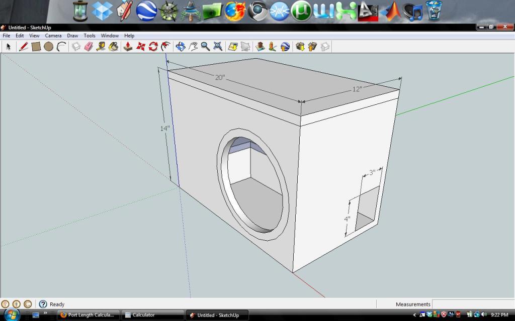

Old Jun 14, 2012 | 12:13 AM
abraves4410's Avatar
Joined: Mar 2010
Posts: 49
From: Jerzey
works out pretty much on par with re's recommendations. 1.3 tuned at 33. should do well with sub up port back
Looks great man, thank's a lot! I trust you, so I'll build shortly after i get my sub.
Old Jun 15, 2012 | 12:53 AM
Joined: Mar 2010
Posts: 49
From: Jerzey
the 45 is optional, but it will really help with reducing noise and help a little bit with spl since it smooths air flow in the port.
