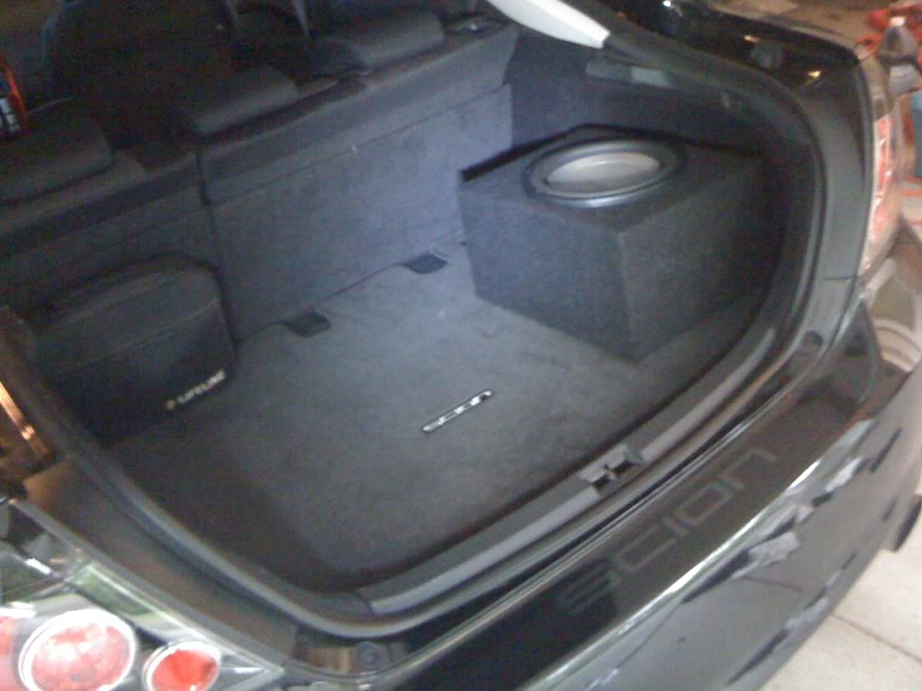

yeah the two items you specified are speakers not subwoofers. you really dont need to limit yourself to a 6 inch woofer though.
look at how compact my 10" sub is in a sealed enclosure:
Old Jul 2, 2009 | 09:35 AM
