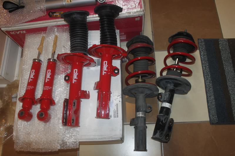

here's a teaser pix!!!

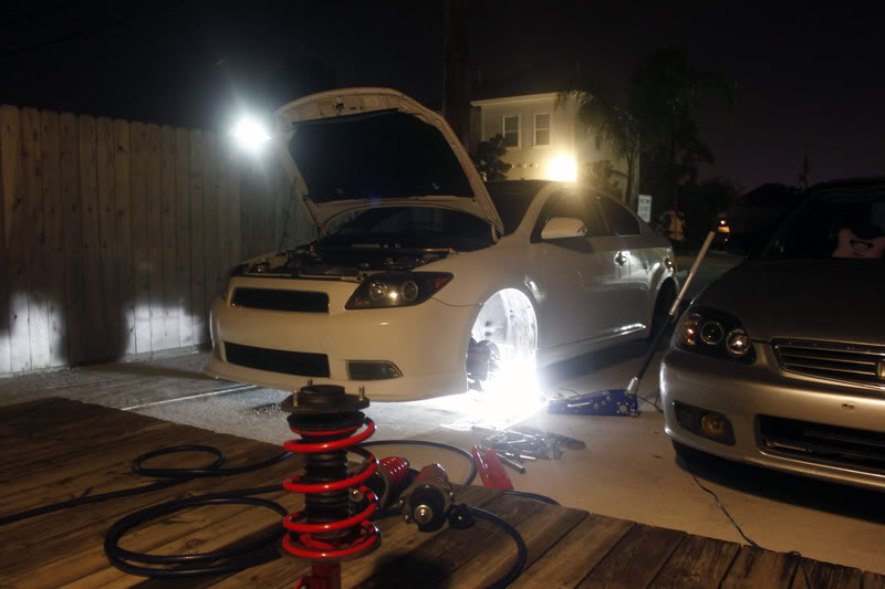

Dang installing on trd struts is a b#### on hand tools had to ran to autozone to rent another spring compresser set, had to max out on the compressor still cant get enought had to use a 3rd one to compress it more!!!
Old Jul 23, 2011 | 08:31 AM
Im2c0oL's Avatar
Posts: 225
From: New Orleans, LA
Finally done install my TRD Struts!!! Start at 6PM, Finished at 2AM! minus 40min go to autozone rent another set spring compressor and BK.

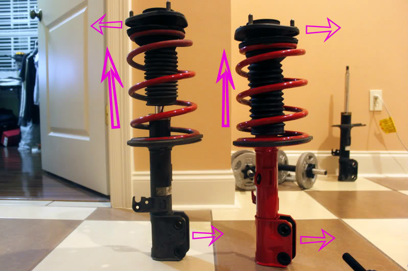

OEM Struts is 23" with the TRD Spring it has a 1/2" freely with no compression.
TRD only 19.5", that's 3.5" shorting which make I have to use 3 compressor max it out in other to get the top mount on. hand tool only

take about an hour to get one done! second strut was quicker. Also you can see the left TRD+OEM the guy assemble it incorrectly, look close into it you'll see!!!

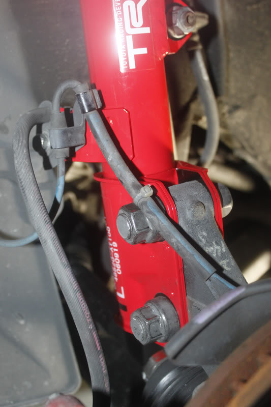

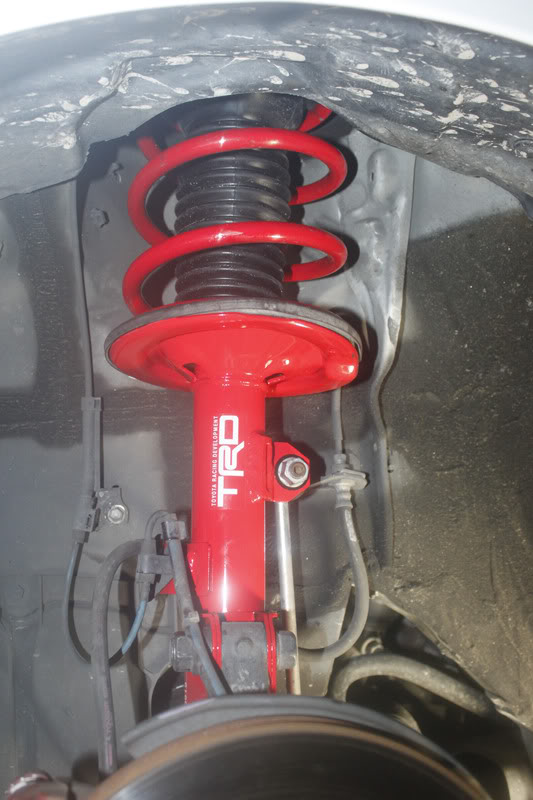

Mounting the front Struts! I always fix my car starting at 6pm, weather here is

The TRD+OEM Struts I made a trade with my RL, the guy assemble the front strut with the top mount face the chassis instead of facing the wheel which flex the struts, spring not seated right give uneven heights = FAILED!!!, the rear spring wasn't seat right also which make the height different = FAILED, gonna remeasure the height tomorrow, and do a DIY Throttle Body cleaning.
