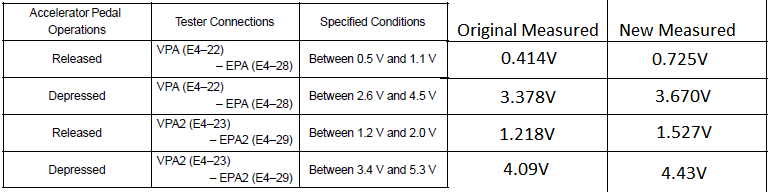

So I checked my sensor values at the ECU and they looked fine. The idle depressed voltage was low for VPA so I unbolted and repositioned the sensor so that it would be within reccomended specs:
No fault codes were logged after this but it usually doesn't show up until after ~25 miles or so. This is a screenshot of me pressing the gas pedal down hard and then instantly releasing it. Should this be more smooth?
Although there weren't any fault codes and I didn't have a "dead" pedal yet, this is me in 3rd gear with the cruise control on:
It feels as though the car is lurking forward. Shouldn't it be much more smooth? Its almost as if I were in neutral and then dropping the clutch; speeding up some; putting it in neutral; finally, dropping the clutch again.
Again I am lost as to what to do next, because the voltages were fine for the sensor and throttle position (seemed) okay and responsive.
