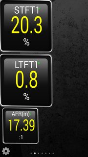

Although I would recommend your tuner do this, you can try this yourself. Back up your current map and save it on your computer. Then you can try to play around with the idle range of the map and latency and see if you can get a stable idle. If you have 750cc injectors, I believe your idle range should be ~-57% to flow similar to 320cc injectors. If you do this, you may need to alter the latency however in order to compensate for the injector opening time. If none of this works, just reload your old map. If it does work, I wouldn't exactly leave it like that because there will be some harsh transitions in your fuel map, but it'll give you something to discuss with your tuner.
I'd recommend you monitor the fuel trims first for evidence that this is indeed your issue. Oh, and check for vacuum leaks too! That'd be embarrassing
Ok. Check to see what it's currently set at. I believe the AEM default is 486us (0.486ms). I wouldn't go ahead and change this yet, as increasing this value will actually cause your injectors to spray longer since the FIC is going to assume that it needs to increase the pulse width more to compensate for the longer lag. What I'm thinking is that the fuel map should first be trimmed so off boost flow is like stock, then the latency setting in the FIC should be raised to get the car to idle properly.

Well, I imagine the LTFT and STFT may not even register when cold, since the ecu is not adjusting your fuel ratios. When warm, that's when you should see the fuel trims in realtime. As a goal, the total trim should be less than +/-10% (adding both the STFT and LTFT). If you are seeing more than that, then the ECU is trying really hard to correct for excessive fuel.
Your tuner should have adjusted this for you by modifying your fuel map until the fuel trims (long term and short term) are as close to zero as possible in the closed loop range. I wouldn't be surprised if this wasn't done, as this is a quirk of using a piggyback ECU and is basically an extra step.
The other thing that will also need to be looked at is the "injector response time" under "setup" in the fic software. I don't know what this needs to be for you injectors, so you may need to do some trial and error. If you do a search on this forum, you may get lucky and find a a recommended setting for these injectors. Generally, larger injectors need a longer response time (the time needed for the injectors to fully open).

I'm glad the O2 map is working better. The way it was before seemed like it would give you a nasty stumble in that region.
I have to admit that I am surprised that running less fuel would make your car run worse. Not what I would have expected. What you could try is zeroing the 3.16 portion of your o2 map temporarily so that the stock ecu is in full control fuel at idle (0 doesn't mean 0 volts, it just tells the FIC to leave the o2 signal alone. Make sure it's exactly 0, not 0.1 etc.). Next,start the car and let it fully warm up, then check the fuel trims. That'll tell you the current fueling situation at idle.
I'm not positive on this, but the 3.16 that's currently in that range may be "hiding" the true AFR from the ECU, making you unable to monitor the true AFR through the OBD2 port. Unfortunately it's tough to troubleshoot without sitting in the car. Post up your findings, and feel free to set it back of things aren't running that well.
Regarding your question about injector lag, my approach would have been to adjust the fuel trims first, then adjust the injector response time until I got a steady idle. However, for some reason you are unable to get there. Are you positive that your setup has no leaks? It's almost as if you are running lean at idle but your injectors are compensating by overflowing stock by 2X. That suggests that air is getting into the system after the MAF sensor, but I'm totally just speculating here.
Definitely make sure there are no leaks, or else trying to correct this by tuning will be futile.

1. Unplug battery and ECM fuse- let stand for 10 minutes
2. Change 02 map to all zero's below boost (all 3.16 values in my table)
3. Flash FIC
4. Plug in battery and ECM fuse, start car and let idle for ~10 min
5. Monitor short term and long term fuel trims, as well as AFR through obd2
6. Adjust fuel map below boost to bring fuel trims near zero- nominally between -10 and +10 (on the y-axis, 13.1 should have values near 0; increasing in negative value towards 3, with values near -57?)
^Should I rev the car here to check for trims at higher rpms? How do I verify trims near boost if the car is at a stand still? What am I monitoring AFR for?
7. After fuel map is adjusted correctly and the values below boost are negative (unlike my current map)- turn off the car and plug the battery and ECM fuse- let stand for 10 minutes
8. Change 02 map to what it was before
9. Flash FIC
10. Plug in battery and ECM fuse, start car and let idle for ~10 min
11. Monitor short term and long term fuel trims, as well as AFR through obd2
12. In setup, change injector lag (increase value from default 486) until idle is smooth
^Does this update in real-time like the maps, or do I need to save and flash?
