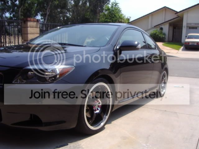

i used to have an 18x7.5 inch wheel with a +42 offset, this is how it should look.. i was lowered on h-techs:
that was with 215/40/18 tires. as you can see they werent exactly flush, i would suggest a +40 offset or even a +35 offset with a 7.5 inch wheel.
