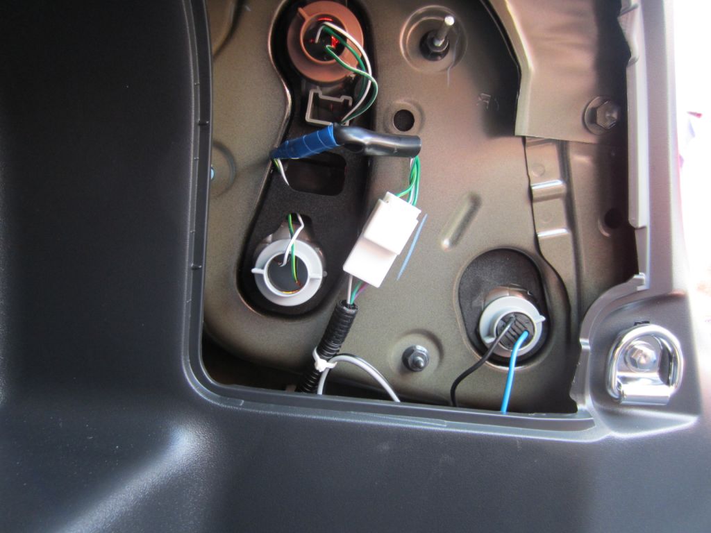

Old Apr 26, 2011 | 10:47 AM

First off, just wanted to thank everyone for the great write ups and tips. I got my socket here:
http://cgi.ebay.com/ebaymotors/ws/eB...96176&viewitem=
And I picked up the 7440 bulb at Advance Auto Parts. I already had some wire, wire taps, and crimp on connects from past stereo installs so I didn't have to buy those. Here are a few pics of the install. Even though the tabs don't look cut out that well, it fits almost as good as the factory plugs.[/html]
Attached Thumbnails DIY: 2nd Reverse Light-img_0091.jpg   DIY: 2nd Reverse Light-img_0090.jpg
