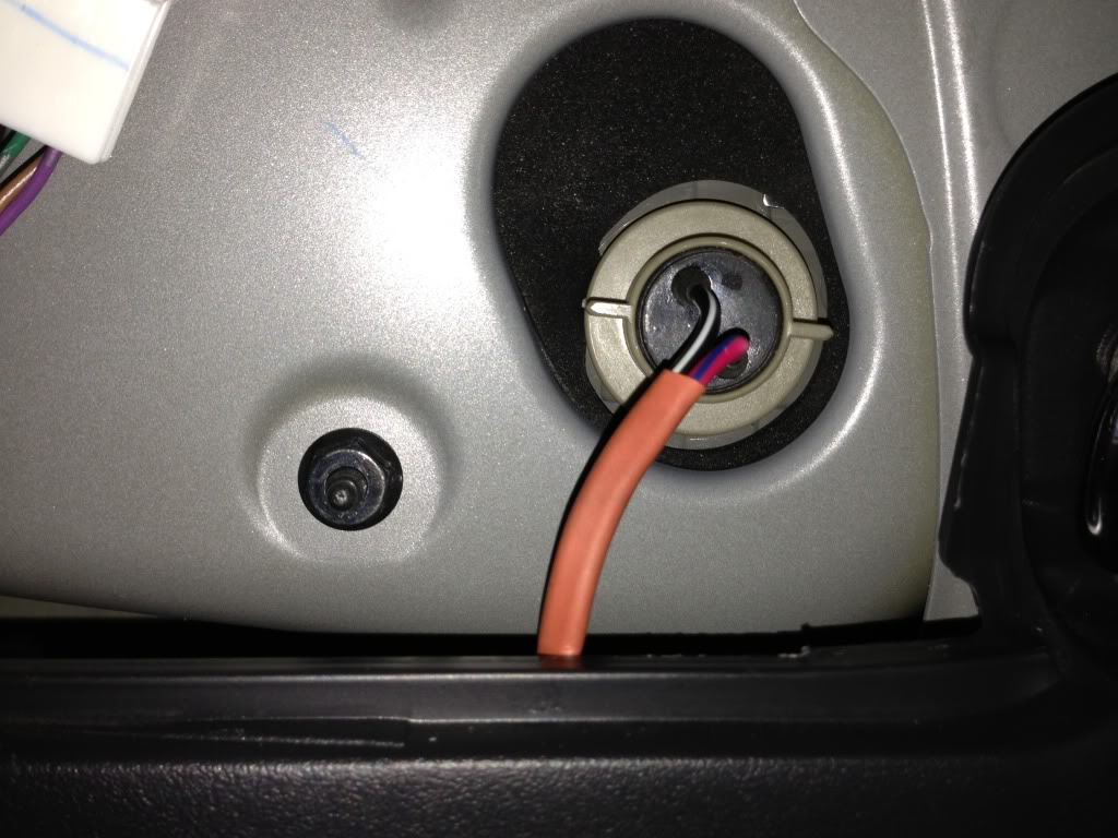

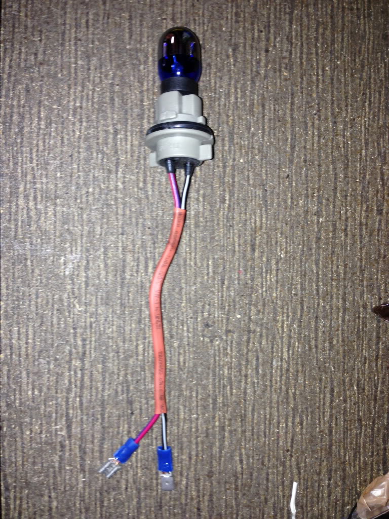

Originally Posted by ivanhoe
my hole has been cut out, socket fits nice and tight! tomorrow i'll try to do the wiring. tookuro, i will report back on which wire is ground.
Thanks for verify the wires, and yes, the black is actually positive, which i find it to be awkward. Since black is usually the negative.

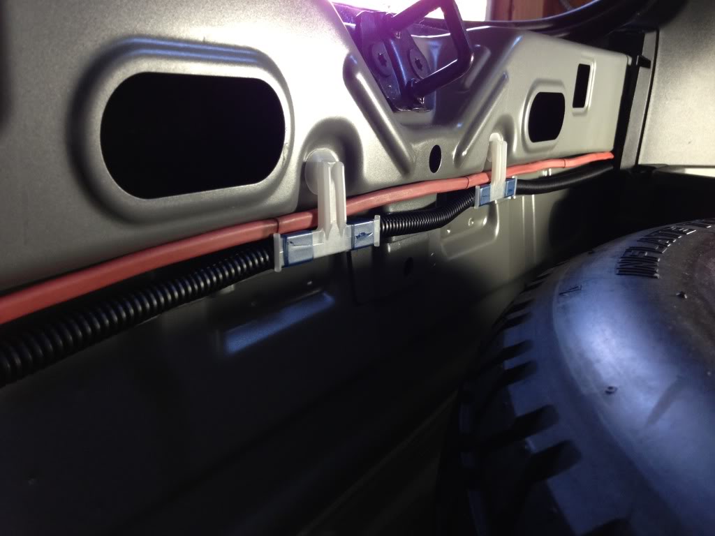

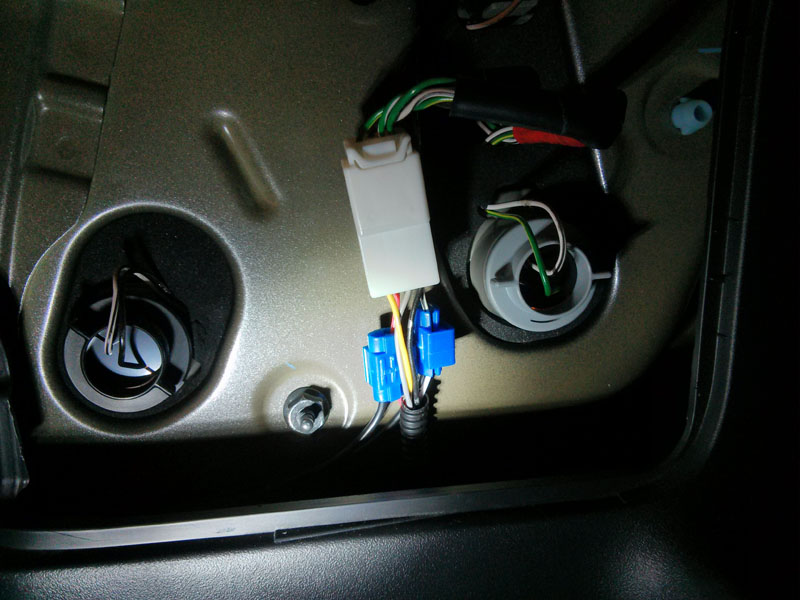

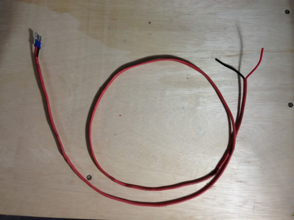

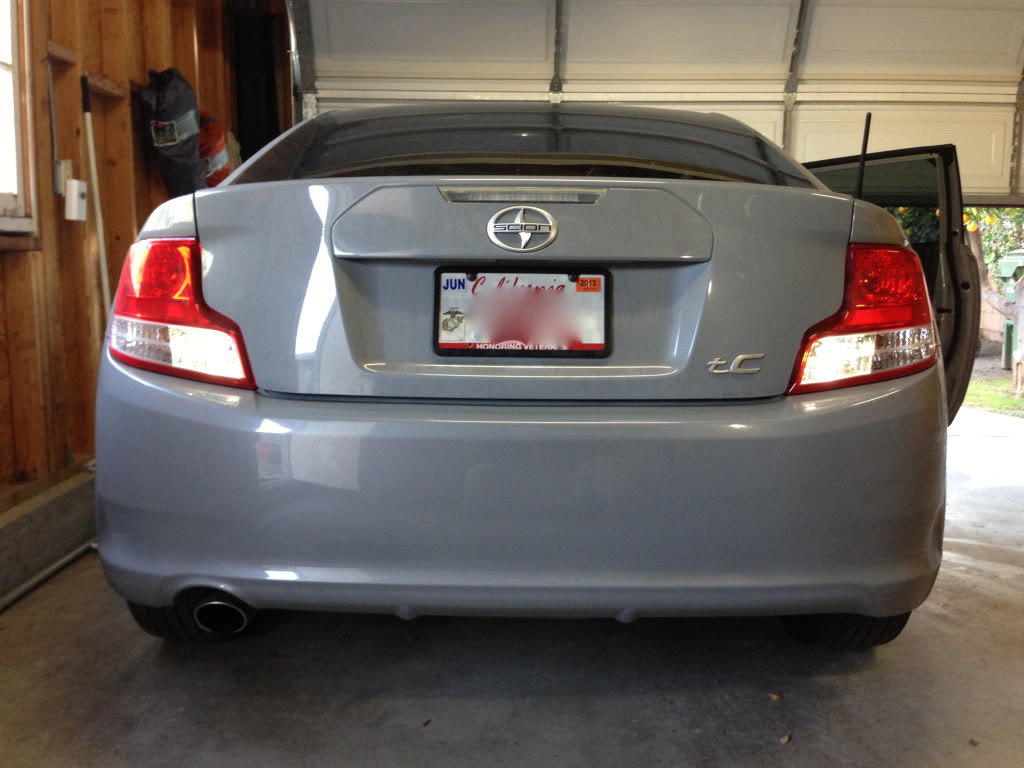

I finally got around to doing this mod. Now I need to get some nice bright LEDs for them.

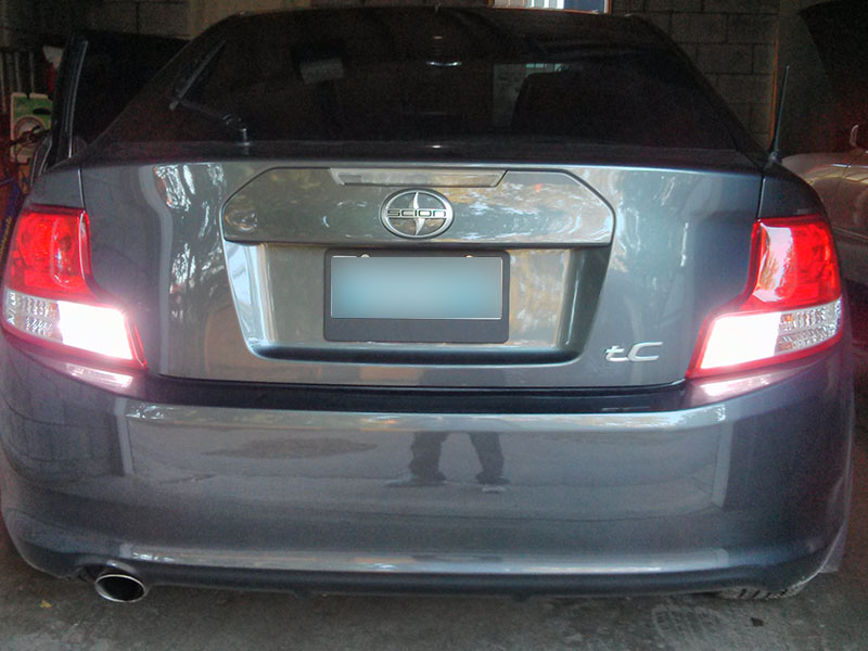

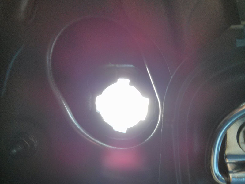

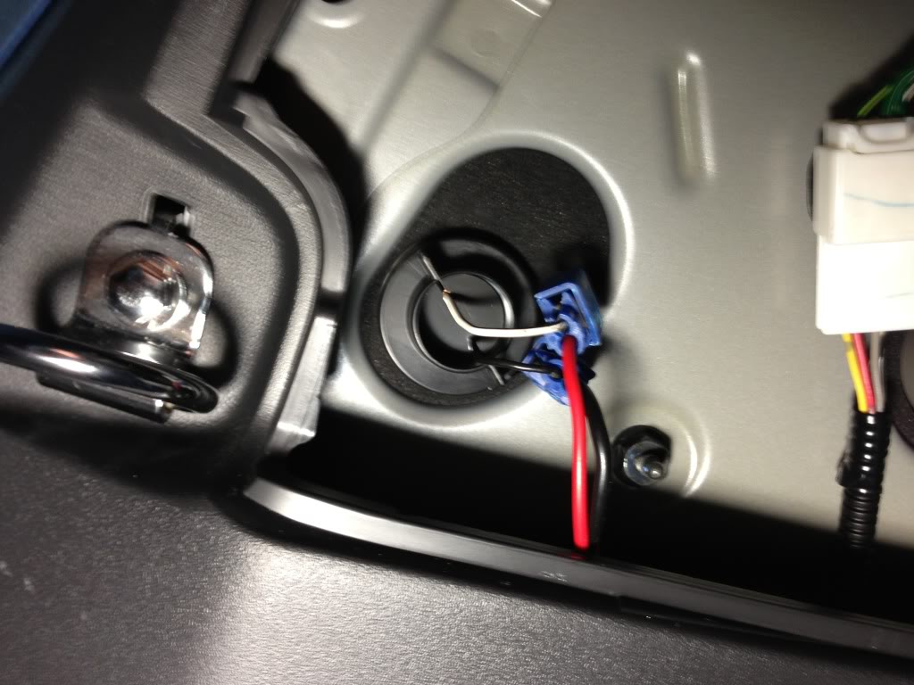

I doubt any 2011 tC owners care at this point (if you were gonna do the mod you'd likely have done it by now), but here you go anyway...

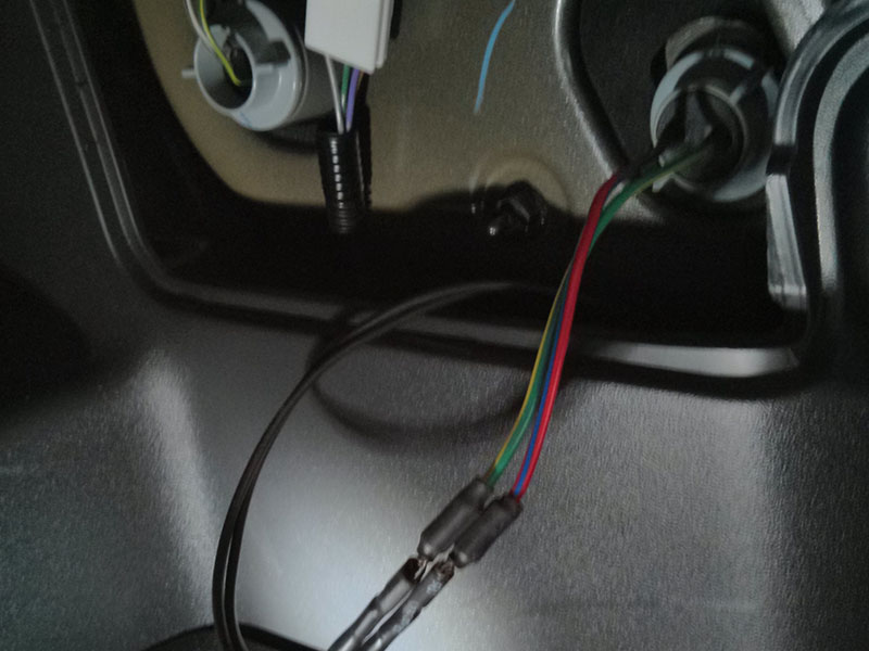

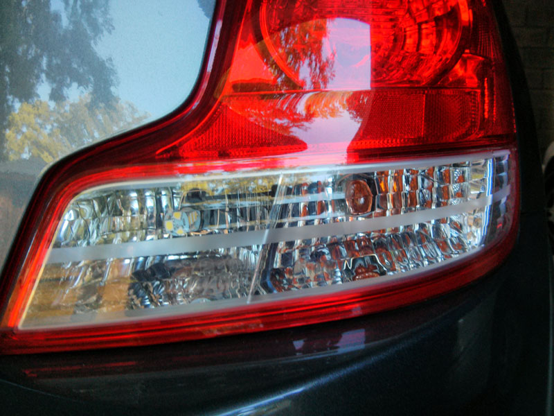

I got the wiring in the other week and it was pretty straight-forward (note the green wires are positive and white/black are negative). Bought the socket for $1.80 and 18 LED tower bulbs for $2.60 each from eBay. I originally got cheaper 9 LED spotlight bulbs but was disappointed with the brightness in daylight so I replaced them. The tower SMD LED bulbs are so much brighter and visible.
Left wiring

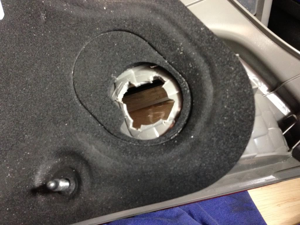

Drilled hole
Right wiring

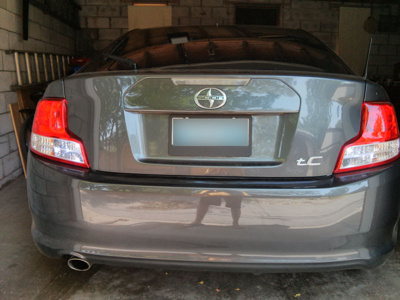

Looks stock
18 LED tower bulbs
9 LED spotlight bulbs for comparison (are they even on? )
