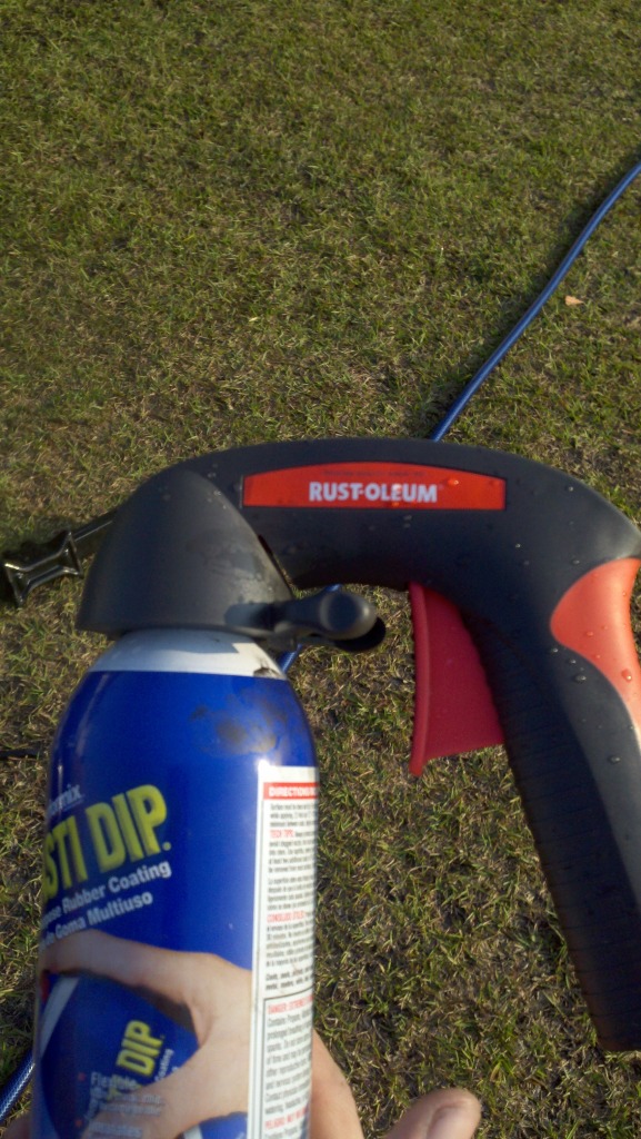

First i had a little left over in a can from a project awhile back i bought a rustoleum sprayer from home depot link is here

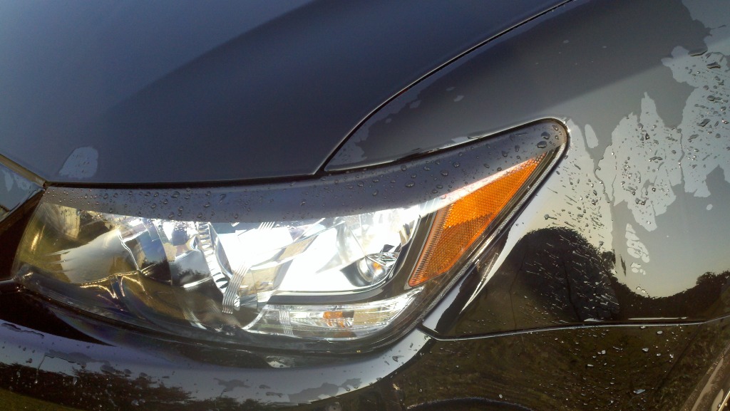

for the technique i tried alittle something different after taping both sides off i sprayed one side with a quick light coat then switched to the other immediately moved back to the other and did 3-4 coats very fast (within 1.5 min) and immediately pealed the electrical tape off... if you let the plasti dip dry before removing the tape you will peal up the edges

you will need to rub off the overspray
here is my finished product

hmm, now i'm not so sure. Maybe we can get a few other views with the car dry?

What did you use as a line? Or was that freestyle? I like how it goes from thick to narrow.
ill take some as soon as my cars clean again plus that will give an idea of how well its held up over the past 3 months

also i just freestyled the line put electrical tape where i wanted to start and where i wanted to end and figured the rest out as i layed it
