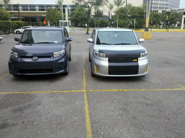

Here's the only picture I have of the front of my xB (on the right). Just imagine the a-pillars blacked out like yours are currently:
