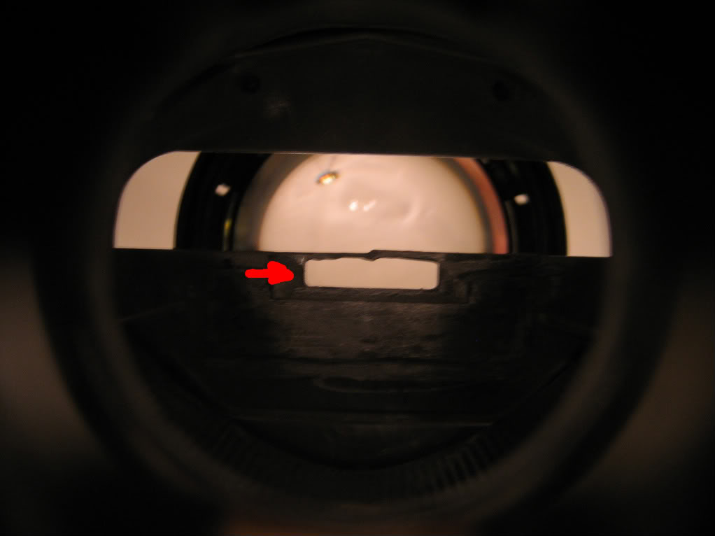

Since I haven't even looked at mine yet. I assume it looks something like this. I'm not sure if this guy has already removed the squirrel or what.

Yes that is what causes the squirrel finders/spotters. There should be an angled flap of metal that was covering that unless you already broke it off (from looking at the picture).
From my experiences with the TC1 headlights:
The metal flap should be angled at about 45-50 ish degrees from the top of that cut off shield, covering that hole and angling down. You'd want to bend it down to about 25-30 ish degrees. Please note this ISN'T a precise measurement. After bending it down, place your bulb back in and fire it up to see if it got rid of it. If not bend it a bit more.
If you bend it all the way flat, you'll get a thin line of rainbow color above your cut off. Like a colorful thin ufo about the cut off lol. You can experiment with it if you like that.
If you do BREAK that metal flap, you now have a gigantic ___ spotter. I covered it up with aluminum tape until I made a new cut off shield with a soda can.
I did all this without taking the headlights apart, until I had to replace the cut off shield.
Again this is all I learned with the TC1 headlights, I assume TC2 are similar. If something is a bit different don't blame me
A good site to check out is: www.hidplanet.com/forums
Theres TONS of info that would be sure to help you out.

I bent mine all the way down, hopefully it will be alright. I haven't finished modding my '08 headlights yet but I'm anxious to get them finished.
It should look something like this:

Thanks for the info. I think I am going to bend it all the way down.
LOL! thats a pretty crazy squirrel!
