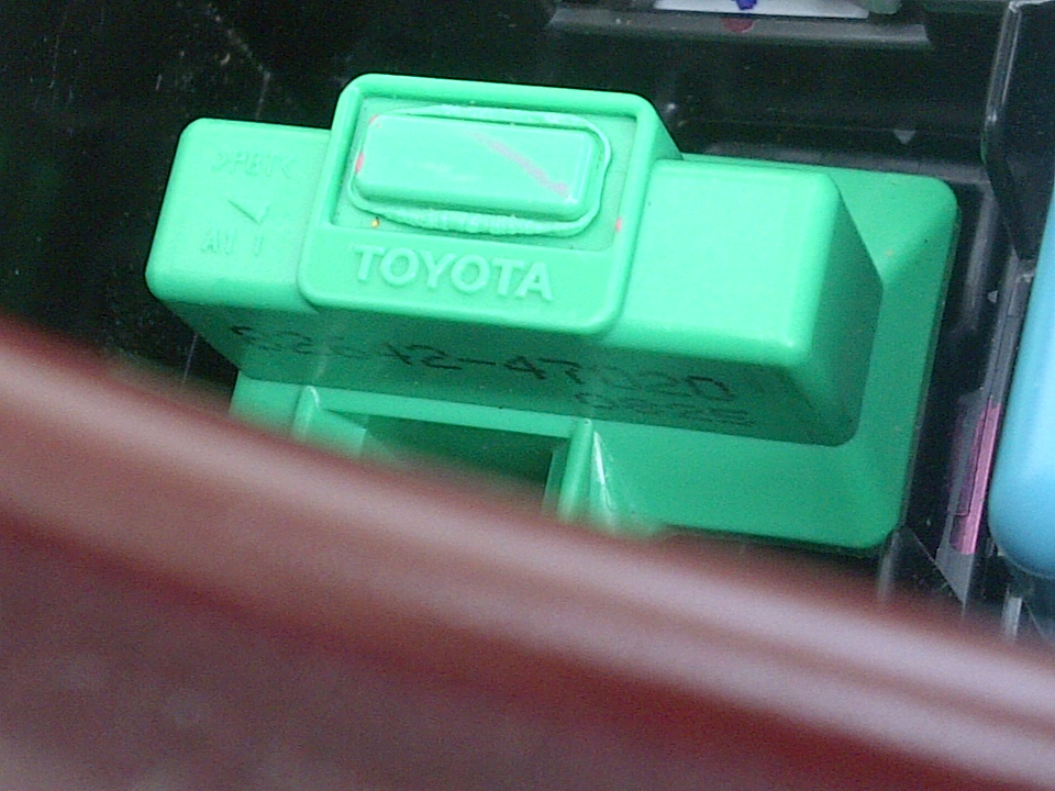

biglilsteve, freedom, or ruizma can you please check your relay for the part number? on my way to the garage to check ours. will post pic in a while.

Here it is...
You can buy the part here...
http://www.toyotapartszone.com/oem/t...642-47020.html
A bit pricey but if you really want it...
I never got the chance to remove the relay and test the DRLs and Dim. It's too tight, I did not bring my pliers and it's damn cold.

Posts: 18
The part number is 90987 - 04010 for the USA blue relay. But now we have the green relay part number, thanks!

I've double checked and the DIM/DRL and DEF both have the same blue relay with the same part number in the USA tC fuse box.
Does anybody have an extra $160.00 to purchase a green relay used in the Canadian tC to experiment with the USA tC? I won't until I get paid in two weeks.
