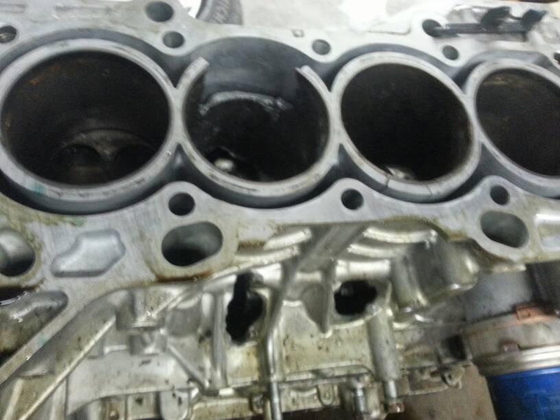

Im sure my numbers are off. Just added for dramatic effect. . He doesnt have to tell the dealer what happen, the cars computer did that for him. Freeze frame data is recorded when the check engine light comes on. Here are a few pics of a s/c civic motor that did the 3rd to 2nd thing at full throttle.
Sorry if its hard to see (taken with my phone) but you should be able to see two holes on each side of the block and a large broken section on cylinder chamber.

You mean the holes that look like a 12 Gauge Slug went through them, we can see them lol. Was that a DOHC or Single. I had a little 1.6 SOHC Turbo back in '03.

That ones a dual 2.0 out of an 07
