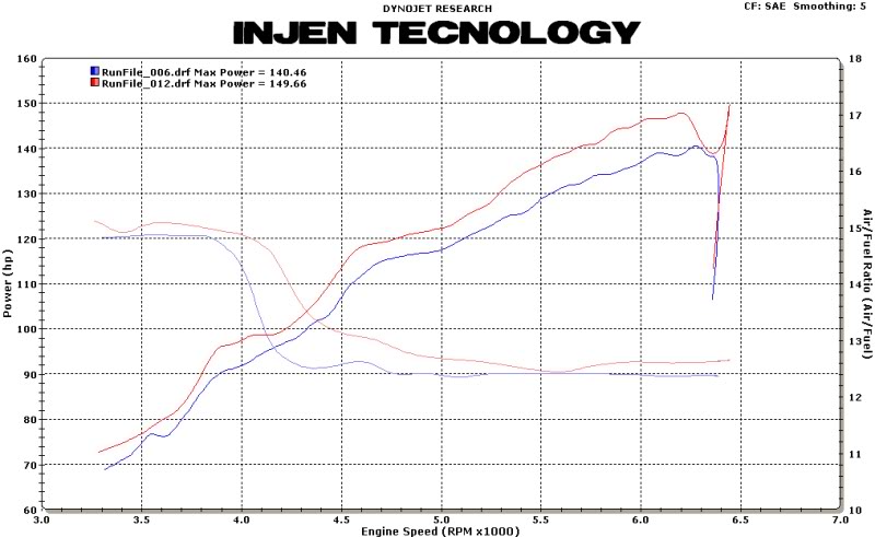

I wouldn't remove that tube. It serves a purpose and the car will run even leaner if removed. The Injen intake does run slight lean in the beginning of the powerband but look how much power you are making there, about 80hp at 3100rpm then it fattens up from there on. Any tuners can chime in and give your input but I've tuned lots of cars and running a WOT 14:7.1 aif fuel at 3100 rpm making ony 80hp would be ok and ideal on an naturally aspirated engine and then fattening it up as RPM climb as with the Injen intake.

Here is a really good example of how lean you can run air fuel at low RPM and low horsepower. This is a brand new bone stock 2012 Ford Focus 2.0L. Red is bone stock and blue is with Injen intake. Just A FYI guys.
