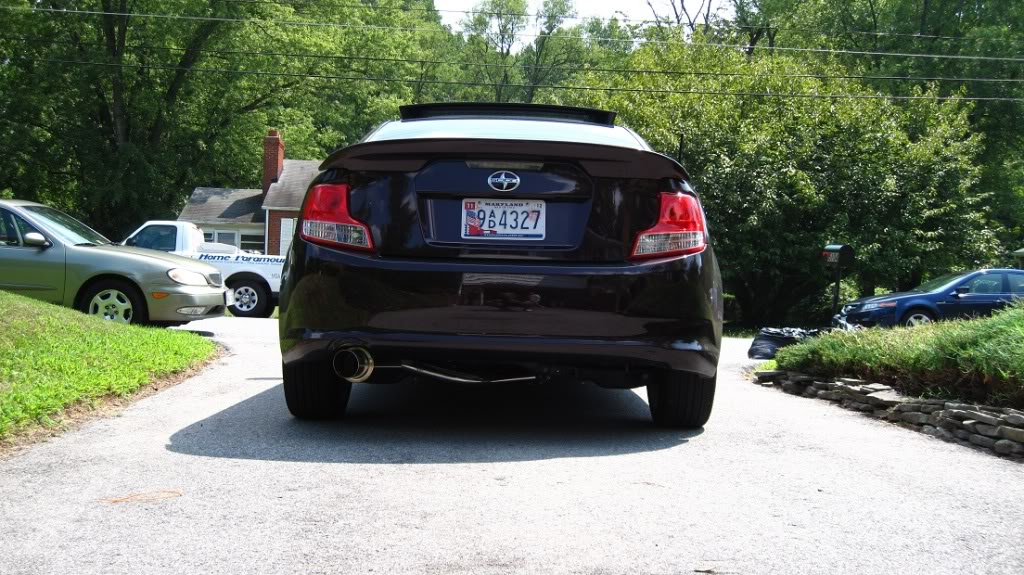

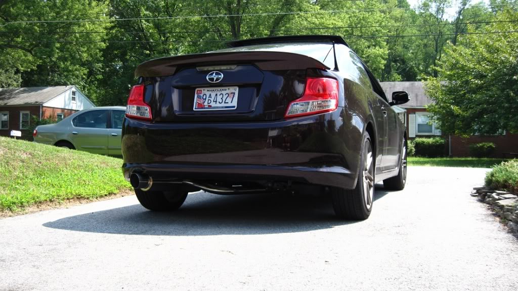

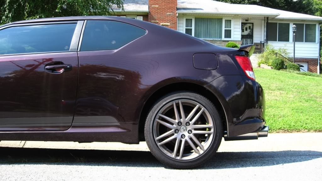

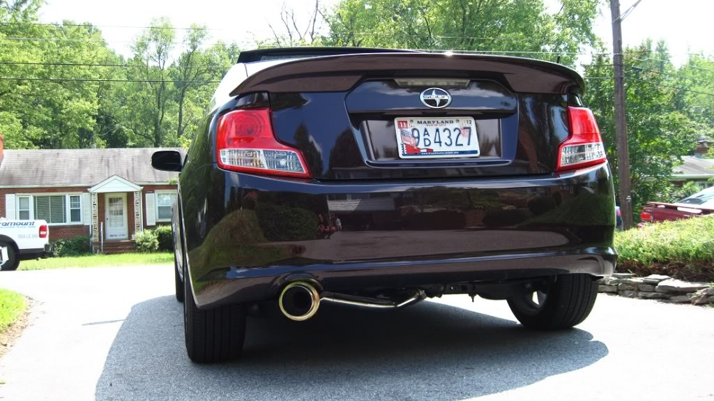

Here's a video similar to what JJ put up. Stock exhaust sound, no exhaust sound, and a few clips of the Tsudo exhaust with and without silencer with drive by. Sorry, I didn't have much room in that neighborhood to ride it out more.
http://youtu.be/aWm2qgrCU6w
Also, here are a few still shots of the installed product.

Forgive the enormous wheel gap in the last pic. Stock springs plus the passenger side of my car was parked on huge sloping curb.
