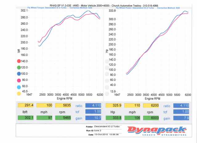

333WHP & 302TQ

Scion rates the car at 180 but when we tested it at Church's Automotive on his DYNOPAK system and it made 198whp & 197tq and at after we boosted it at 8-9 psi it made 333whp & 302tq
STOCK...
TURBO...

awesome power on just 8-9psi

I have to admit im overwhelmed by the numbers put down but i guess chalk it up to a slightly larger engine and high comp. Nice work guys!!!!

I think the reason the stock dyno numbers are so high is Dynapack I'm not saying that Scion did not underate engine just that it may be 10-15hp less.because Dynapack read off the hub so its always a tiny bit higher. Only reason I like Mustang Dynos better is Mustang Dyno's require you
to manually enter vehicle weight and environmental conditions. Therefore either inflating or deflating dyno numbers are possible. The real benefit to the Mustang type Dynos are their ability to put a load on the car and as others have said, simulate real world driving conditions for tuning purposes.

i think the reason the stock dyno numbers are so high is dyno pack im not saying that scion didnot underate engine just that it may be 10-15hp less.because dyno pack read off the hub so its always a tiny bit higher...Only reason i like mustang dynos better is Mustang dyno's require you to manually enter vehicle weight and environmental conditions. Therefore either inflating or deflating dyno numbers are possible. The real benefit to the Mustang type dynos are their ability to put a load on the car and as others have said, simulate real world driving conditions for tuning purposes.
Ahh, you must work for Mustang?

Naw I've just been around a lot tuned cars..and different Dynos.. and different drivetrain losses.
I prefer Dynojets...over either
