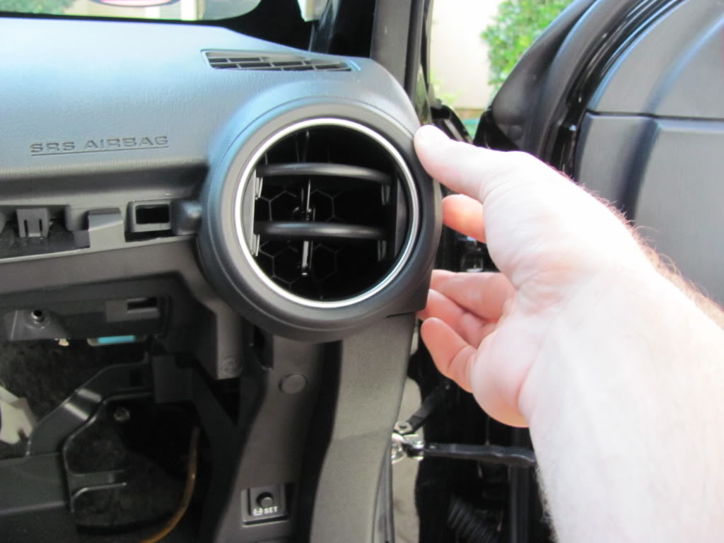

-The drivers vent and the middle vent can be easily taken out the back once these few screws are removed
Attachment 43870
-The aluminum trim can be pulled off of the vents by pulling the multiple clips around them and then pulling the trim off
Attachment 43871
-The passenger vent can be removed by pulling off the 2 clips and pulling the vent out the back
Attachment 43872
-The aluminum trim can be pulled off by pulling the clips up and pulling the trim off the front
