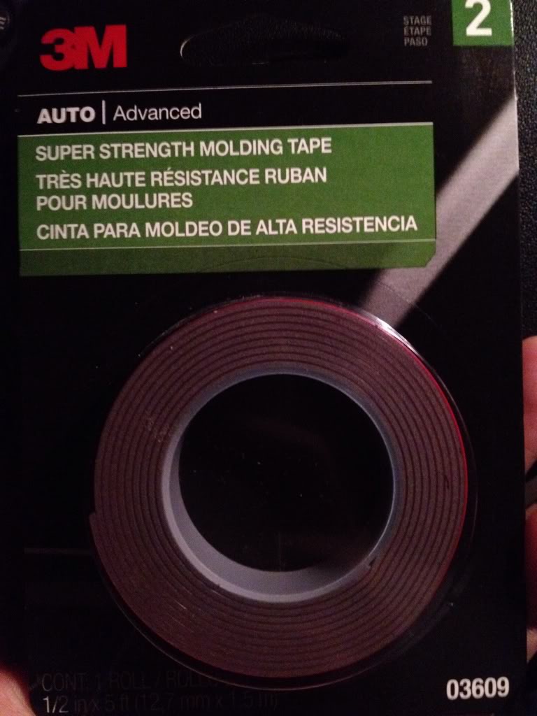

Thanks! I finally got around to doing this and decided to use this!
I did the driver side just now and it works great and has no buzzing!! This seemed to be perfect and there was very minimal cutting! I also got it at Wal-Mart, but I've seen it for sure at Advance Auto Parts. I assume they would have it at AutoZone too.I found the foam he suggested, but like most of you have found way too much for a small project. I paid like $5 for it btw. Good luck!
