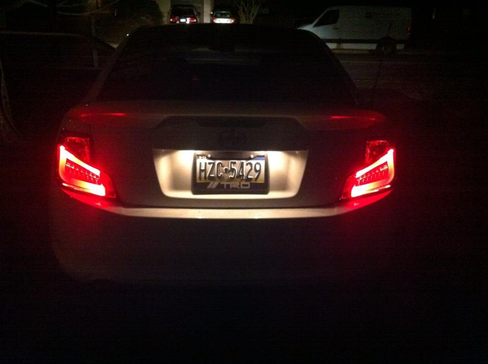

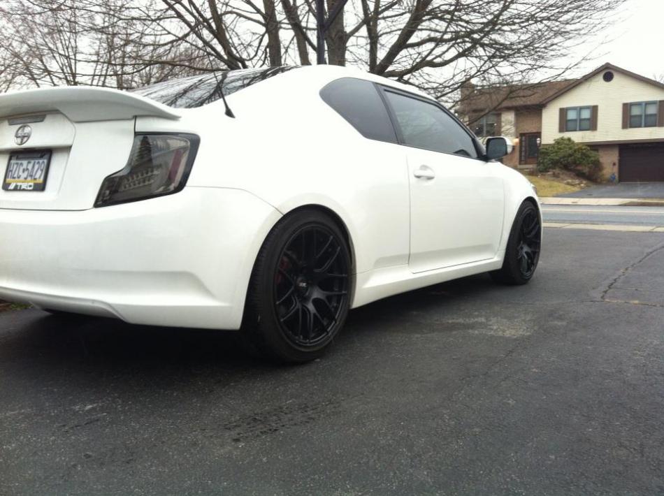

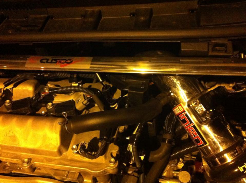

I've been away for a while from the forum, but while i have been very busy keeping the Tc2 looking good.
I am now sponsored by Andy's Auto Sport.
I added spec-d tail lights,
XXR 530 wheels
and also an Injen intake system
check out the pictures and everyone's feed back is much appreciated.

Looks very good! I've ordered the same lights for my white tC and already have the same intake. What are the size of these wheels?
Old Feb 26, 2013 | 02:28 PM
  #47
Jsche893's Avatar
Joined: Jan 2013
Posts: 49
They are 18x8.75

which offset did you get? any spacers?
looks amazing
Old Mar 6, 2013 | 01:55 PM
  #51
Jsche893's Avatar
Joined: Jan 2013
Posts: 49
No wheel spacers. +20 offset. They are 18x8.75 I had to roll the fenders and stretch the tires because a wider tire won't fit with the fenders even rolled haha.
Old Mar 6, 2013 | 02:09 PM
  #52
P33kAb00B's Avatar
Joined: Jan 2013
Posts: 104
From: Sorel-Tracy, QC
Would I have to roll fenders with a 33 offset on these?
Old Mar 6, 2013 | 02:18 PM
  #53
Jsche893's Avatar
Joined: Jan 2013
Posts: 49
How wide of a rim?
Old Mar 6, 2013 | 02:46 PM
  #54
P33kAb00B's Avatar
Joined: Jan 2013
Posts: 104
18x8.75 +33
I've sent an email to nlmonitoring.com and they said these wheels would fit perfectly in 18x8.75 +33.
Actually, an employee has the same exact setup on his tC with stock tires and no drop from what I can see on the image.
I'm asking you because I don't want to get wheels that don't fit.
I'm dropped on TRD (1.2'' all around).
I assume that a tc with no drop, almost anything would fit?
Thanks for help.

Yeah I have Megan springs on which dropped mine 1.4" all around. And I also had to do a custom alignment with a little extra negative camber. But I would roll the fenders just to be safe. What size tires are you going to use?
Old Mar 6, 2013 | 03:47 PM
  #56
P33kAb00B's Avatar
Joined: Jan 2013
Posts: 104
I want to keep the stock ones. The car/tires have only 15000km.
Old Mar 6, 2013 | 04:05 PM
  #57
Jsche893's Avatar
Joined: Jan 2013
Posts: 49
Yeah that's what I did. They will be a little stretched but still good.
Old Mar 6, 2013 | 04:07 PM
  #58
P33kAb00B's Avatar
Joined: Jan 2013
Posts: 104
I don't mind a little stretch as long as it's safe and not causing premature wear on the tires.
Thanks for sharing!
