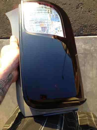

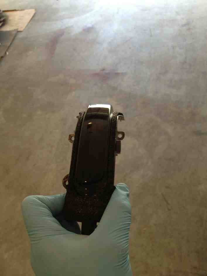

Her name is SEIKETSU =D (Build)-imageuploadedbytapatalk1361370399.873138.jpg XB
Her name is SEIKETSU =D (Build)-imageuploadedbytapatalk1361370415.107694.jpg
Two different xbs
Her name is SEIKETSU =D (Build)-imageuploadedbytapatalk1361370435.387909.jpg
Mirror

nice bro! good job! how did you get your side mirror out?

all u have to do us pop the mirror cover off and there are two small screws holding the light in

Sorry I'm confused. What's up with the xb pictures?

REALLY?! are there clips to pop the mirror of or something? if you have pics it would help plz =)
fatty gen2: lol he was showing me his work and how he painted the housing and tinted them

Hell yeah!!! Thanks for the explanation to that guy. You literally just pull the mirror cover off, start at the bottom u can take a small small flat head and separate the black and painted cover ,and just pull it. Be careful though and work it slowly. But it pops right off

It's actually just a led, you would have to completely take it apart and solder a new led on it
