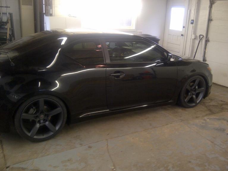

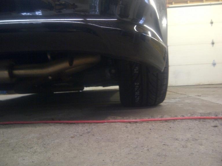

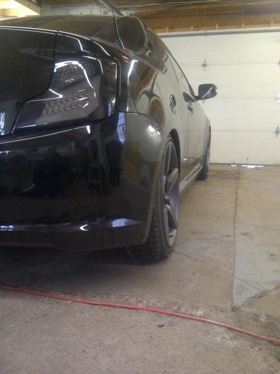

Hey Mike
Here's my ride dropped on D2 coilovers with 19x9.5 et45 R5:F's. I'm tucked all the way around on 245/35-19 Hankook Ventus V12 Evo's. I've got room to come out about 15mm so I'm probably going to add spacers to fill the gap. Fronts are less than 5mm from the coilovers but no rubbing anywhere... Hope it helps!
Attached Thumbnails Will This Wheel fit? (Guide to Offsets and more)..-rims1.jpg   Will This Wheel fit? (Guide to Offsets and more)..-rims2.jpg   Will This Wheel fit? (Guide to Offsets and more)..-rims3.jpg

12BlacktC2 you need to retake some pics outside in the daylight cause it looks blurry. Also its a very low res. Don't you have a regular camera, not a phone pic?

The coilovers are down about 3/4's of the way. I can go lower but I installed the drop before I added the new rims and tires... I wanted to see how everything was going to fit before I slammed it.
The rears fit great. The fronts are super close (about 5mm) from the springs because the rims are a +45 offset. I am going to add spacers all the way around just to bring the rims out to the fenders. Probably 10 to 15mm. 15's are on order and if needed I'll slim it down to 10. I haven't rolled the fenders yet either.
In terms of pics; Unfortunately all I have is my camera phone... Once the interior is done I want to have some professional pics taken. I'm just waiting on the seats and I have to finish installing the interior accent lighting... I'll prob start my own build thread once its all put back together

Instead of spacers, why not just have gotten the 35 offset version of your wheel instead? It would have given you a bonus of being slightlyyy more concave and will naturally stick out 10mm as you want.
Can you take a quite shot of the rim from the side so I can see if the tire looks stretched at all? Thanks

I'm most likely gonna have to roll the fenders... I took the +45 offset just b/c of the sweet deal that I got on them.
I'll definitely get some more pics up asap! There's very little stretch on the 245's wrapped around the 9.5's. But that truly varies tire to tire. Tirerack was awesome with the info on their website. For most of the tires they actually list tread width which can have a big impact on the stretch. Personally I wasn't looking for a lot of stretch thats why I went with the Hankook's....
