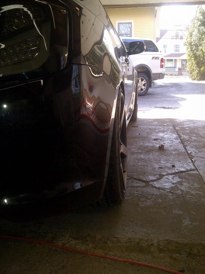

12BlacktC2 Are those pics coming pony express or what? I just need a closer shot of the wheel area. Im not looking for anything special. I really want to see how concave the wheel is and how it racks up with the fender.

Sorry this is the best shot I have at the moment...

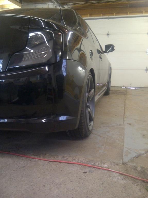

And here's a quick shot. I just added 15mm spacers all the way around. Original rim size is a 19x9.5 et45 now pushed out an extra 15mm basically making it a et30.

Are you going to add a rear camber kit to the back? Also with that much tire directly under the fender, I'd assume you'd have to really stiffen the suspension so the tire doesn't hit the fenders. Kind of kills the comfort eh.

I do need a rear camber kit; also probably going to have to roll the fenders.... Close right now but I haven't had it out on the street to test it. My seats are due back next week so I can get it back on the road.
And yeah I've got the suspension pretty well tweaked. I'll fine tune it once I get to take the car out again but I know its going to be tight. I built it for looks and performance; unfortunately comfort had to be sacrificed... Luckily it's not my daily driver otherwise I probably never would have taken it this far.

12BlacktC2 do you have any fender clearance shots of the front wheel since all you linked was the rear? I want to see how far the wheel is sticking out beyond the fender.
