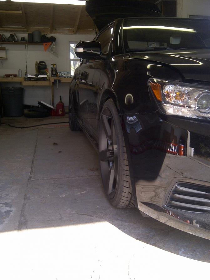

Best I have at this moment. Still haven't been able to get the car out of the garage to fine tune the suspension settings. Hopefully I'll get the interior finished up later this week and have it back on the road next week...

I appreciate the effort but could you have at least gone up a little closer? LOL

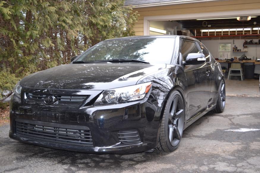

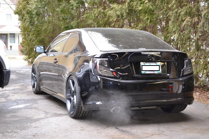

So... I finally got the interior done and took the car out for a test drive last night. I'm running a 19x9.5 et45 and had put on 15mm spacers. That fit works perfectly in the rear with no rubbing at all. The front on the other hand unfortunately had some major rubbing issues. I pulled the spacers off the front and ran it again with no rubbing at all. I have not rolled my fenders yet. I think to put the spacers back on I would definitely have to roll the fronts and probably do a little pulling... At this point I'm just going to leave the spacers off the front.
Excuse the dust; here's a few pics before I pulled the front spacers off. Sorry still no close-ups. I'll work on that as soon as I can get the car detailed!!!
Attached Thumbnails Will This Wheel fit? (Guide to Offsets and more)..-front-corner.jpg   Will This Wheel fit? (Guide to Offsets and more)..-rear-corner.jpg   Will This Wheel fit? (Guide to Offsets and more)..-seat-pic-1.jpg

Really liking the dark theme you have going. Tint 3rd brake light as well when you get a chance. As far as spacers go on the front, you may want to try a 5mm. That 15 is way to aggressive for your setup. I could've told you sooner but i guess missed it. I ran 245's with the 19x8.5 +30 and rubbed every now and then and that was also with the CF fenders which are 10mm wider than stock.

i'm running 235's 19x8.5 +30 (also five axis) and its a perfectly flush as-is...no spacers or fender rolling needed
(Troy kind of did that size on purpose for a reason...the reason why the rear doesn't get flush on that fitment is an issue with the tC and not wheels)
