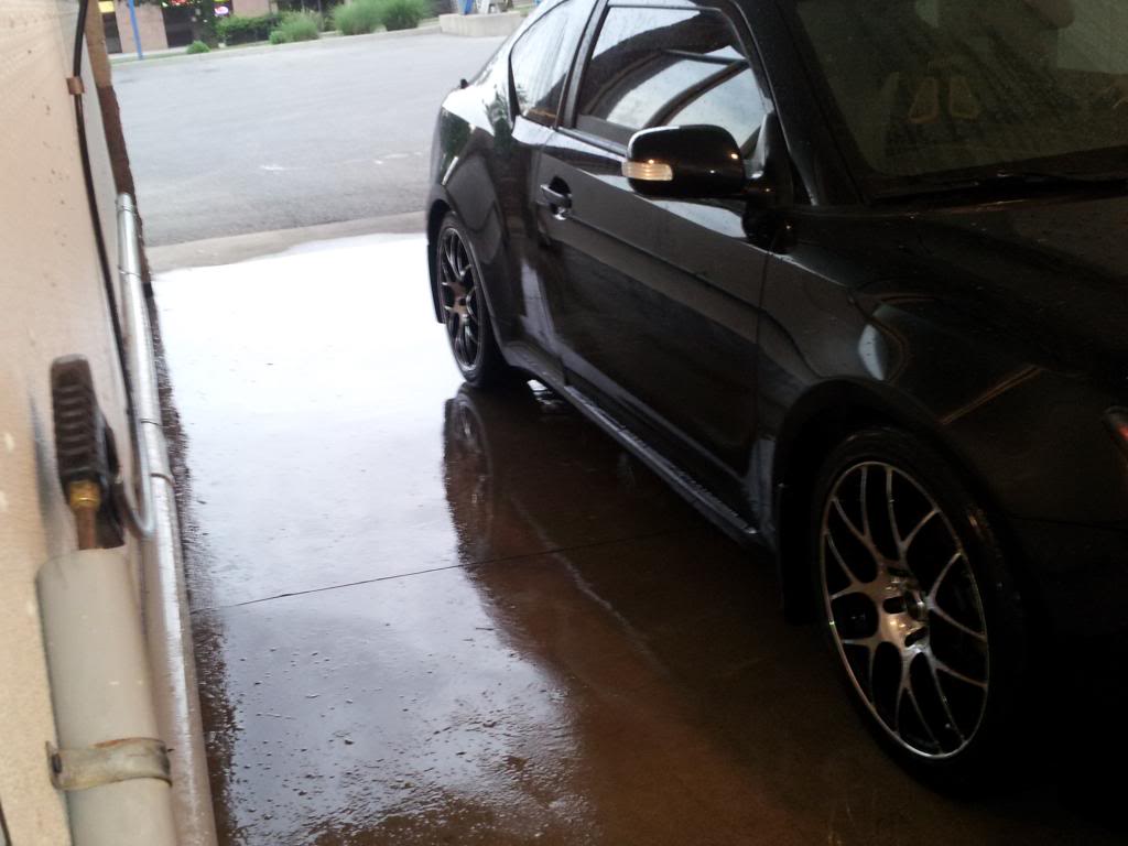

9mm is less that I expected, they do fit with no problem but I decided to go with a diffrent wheel with a lower offset like the OEM wheels. Wheels should be on the car by Sunday. Pics of them on the car if all goes smooth
35th Anniversary GTI wheels
18x8
+40
73.1 center bore and i added centric rings

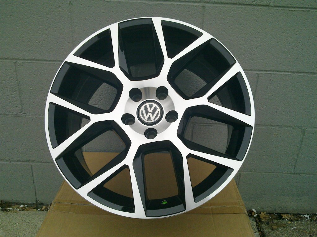

1. STR 613 19x8.5F/10R Offset: +35F/+40R
2. 235/35/19
3. TRD Springs
4. Don't want to roll them
I saw them on eBay and I liked them. Will they fit tC2 being staggered? Any photos will help.

yes they will fit, im running 10.5 in the rear but its going to be close to rolling the rear fenders unless you go with a smaller width just to be safe

I know. I wish that the rims were only 8.5 wide, but it's a staggered set. We'll see what happens as I am not buying them now.
