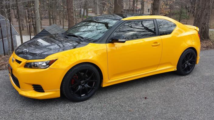

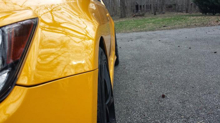

v_erge's Avatar
Posts: 38
From: Maryland
Just contributing.
SSR GTV03
18x9+35
Hankook 245/40
TRD lowering springs
This size and offset really gave me what I was looking for. Really happy.
